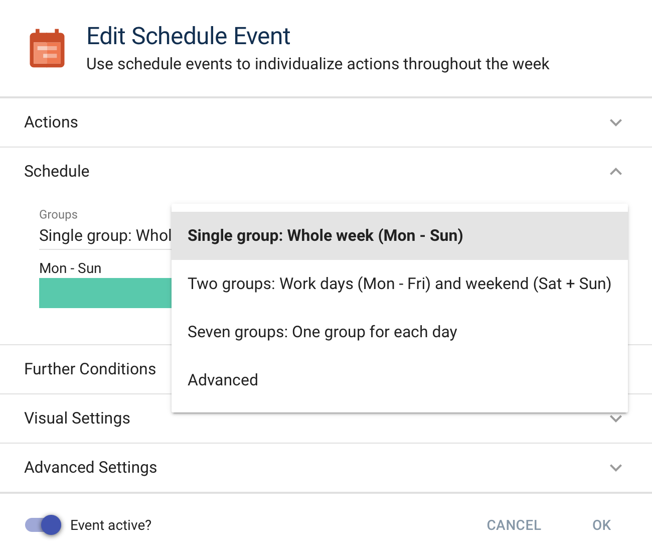

Group Types
There are four options
Groups
Type Description
Single group: Whole week (Mon - Sun) All week days are summarised in a single group.
Two groups: Work days (Mon-Fri) and weekend (Sat + Sun) Splits the week into two groups and allows the days from Mon-Fri and Sat+Sun to be configured independently.
Seven groups: One group for each day Every week day can be configured individually.
Advanced The week days can be combined as required. Each combination is summarized into one group and can be configured.

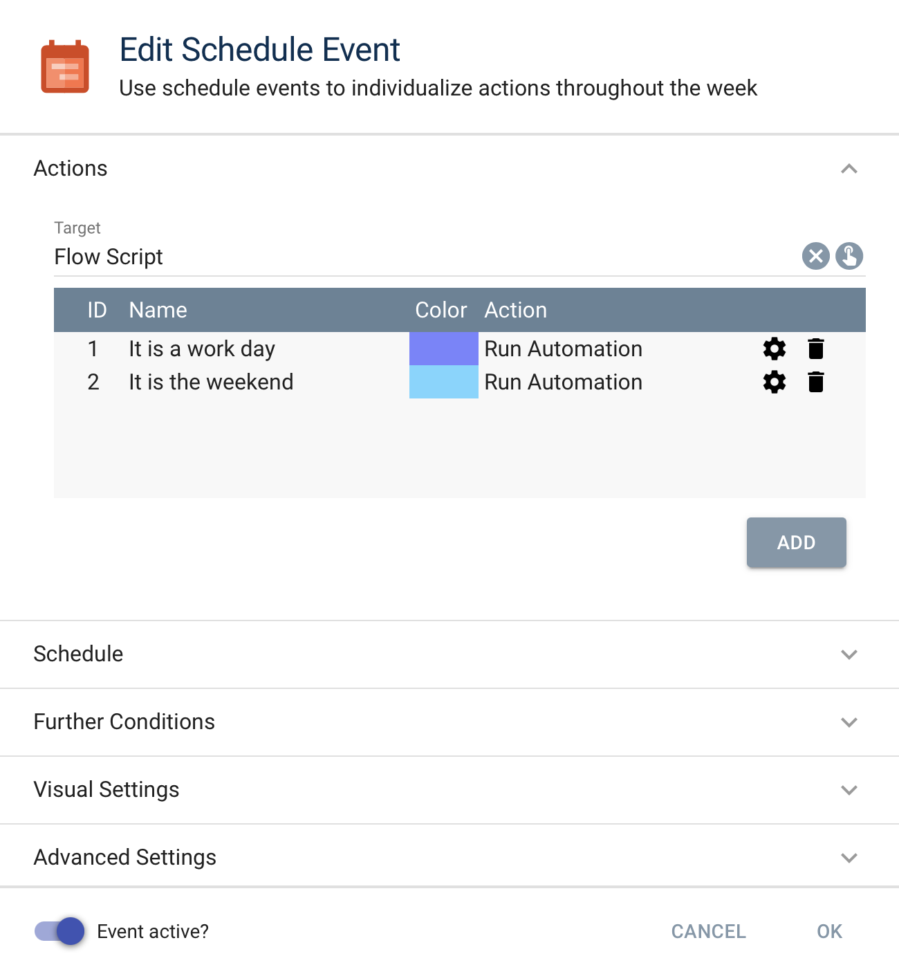

Actions
The schedule offers actions depending on the selected target. At least two schedule actions need to be configured. As part of the schedule action, an Action is defined for the target.

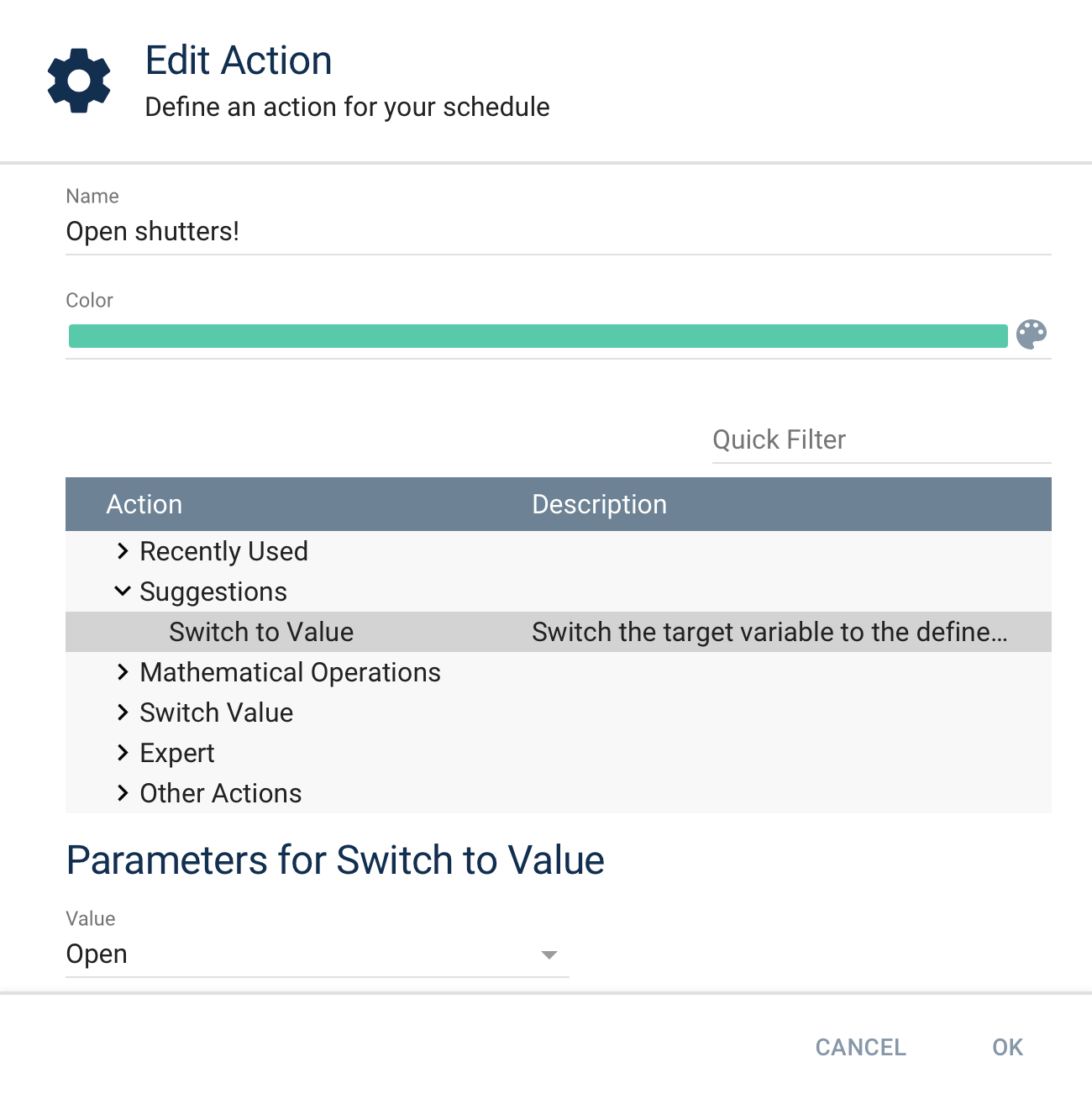

Add schedule action
A schedule action can be added by clicking on "Add". For the schedule action, a name, a color, and an Action are selected.
Add schedule action
Configuration of the schedule actions

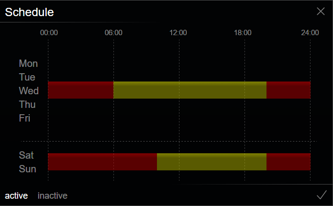

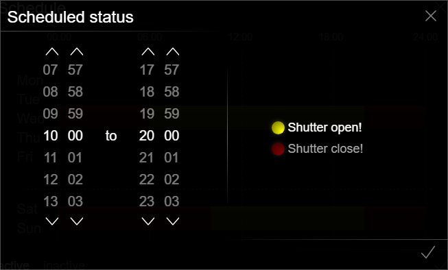

The durations of the actions can be configured within the Management Console or the WebFront.
Within the grafical interface, the following applies:
Single Click configures an existing state.
Click & Pull creates a new state.

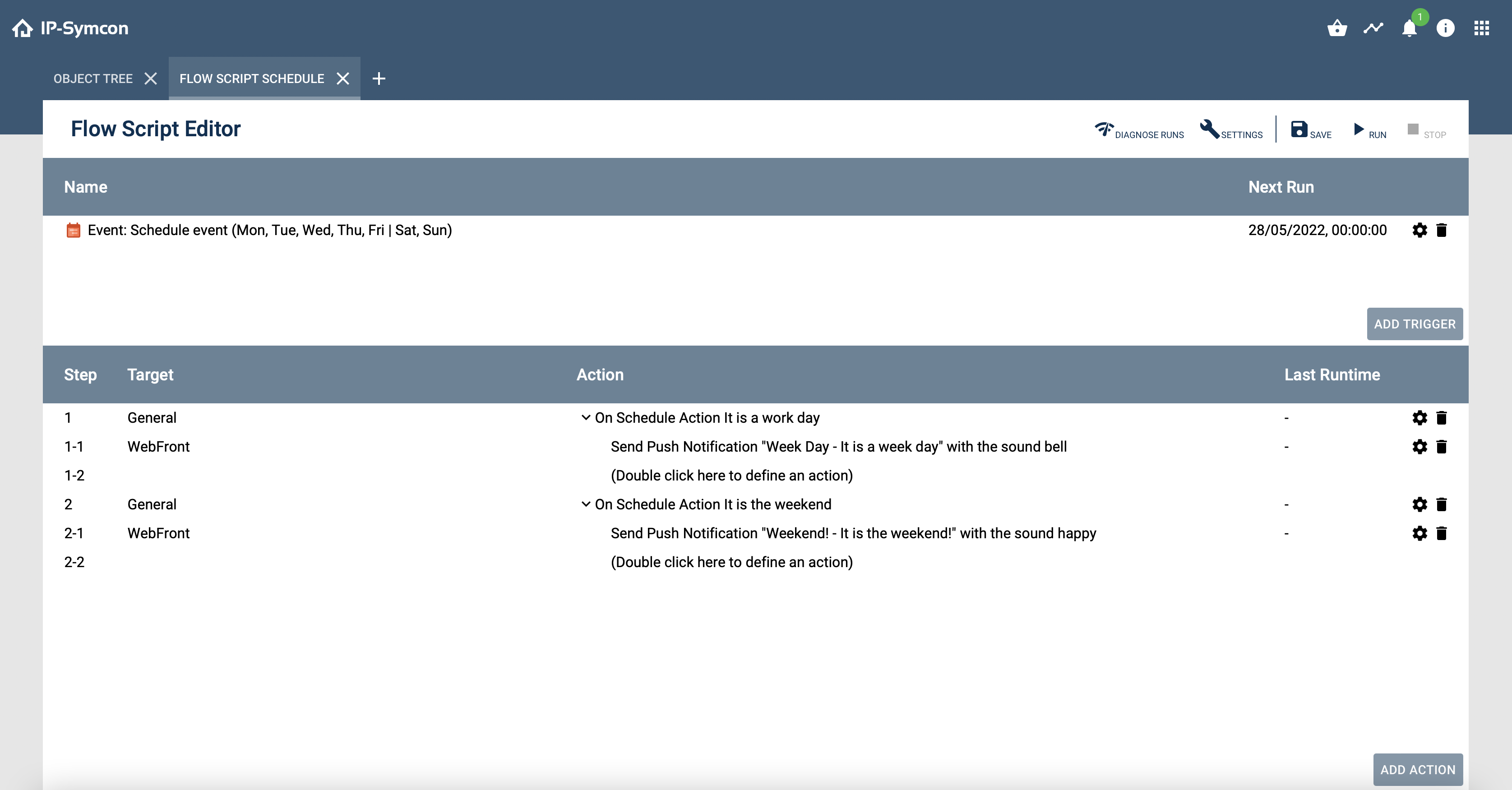

Bind to flow script
If the action "Run Automation" is selected for a Flow Script, the action "On Schedule Action" can be used to execute a number of actions on a specific schedule action. When the first schedule is added as trigger, the "On Schedule Action"-actions are added automatically.
Flow Script Actions
Example with flow script
This is an example flow script which is executed via schedule.
Flow Script

If the action "Run Automation" is selected for a System Variable $_IPS['ACTION'].
Example with script
This is an example PHP script which is executed via schedule.
