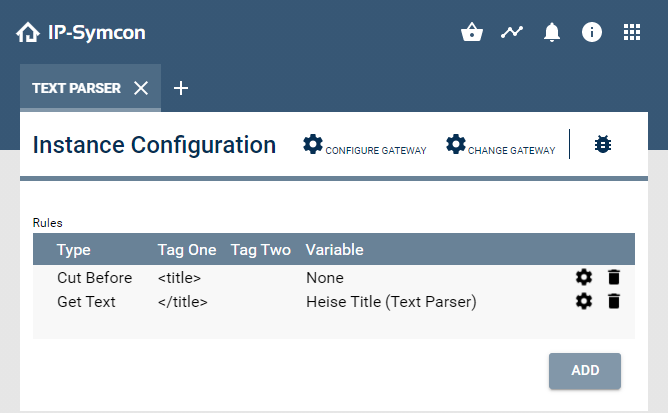

A small example will show how to read the first headline of heise.de to show it e.g. in the WebFront.
  1. Create a Text Parser.
  2. Next, create a parent instance. In this example, a HTTP Client is required.
  3. In the HTTP Client, the URL https://www.heise.de must be entered and eventually the timer activatec, which requests the page cyclically.
  4. Back in the Text Parser, the HTTP Client needs to be configured as Gateway. It can be selected via "Change Gateway".
  5. In the Text Parser, the following rules need to be defined to read the title. These rules can be deducted by looking at the HTML Code that is read by the HTTP Client. In the code, it should be searched for significant parts, that should be cut. This is repeated until the desired text remains. Those rules are the entered into IP-Symcon.
  6. With "Get Text" a variable is defined where the completely cur text is saved.
Rules
Description Rule
Cut Text Before <title>
Get Text </title>
