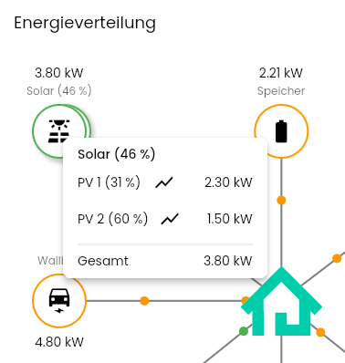

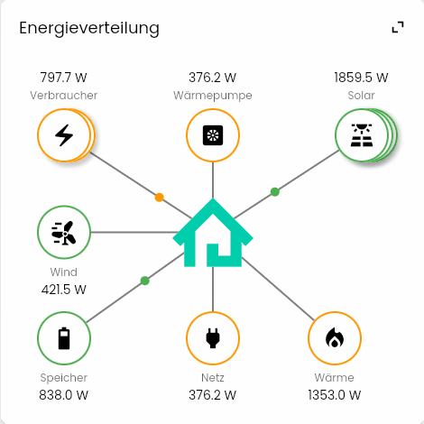

Visualization
Each device and each group can be clicked to display a breakdown of the individual values. Once the selected variables have been logged, the corresponding diagram can be opened directly.
If required, a resource-saving mode can be activated by clicking on the house in the middle, which replaces the moving points with static arrows.
