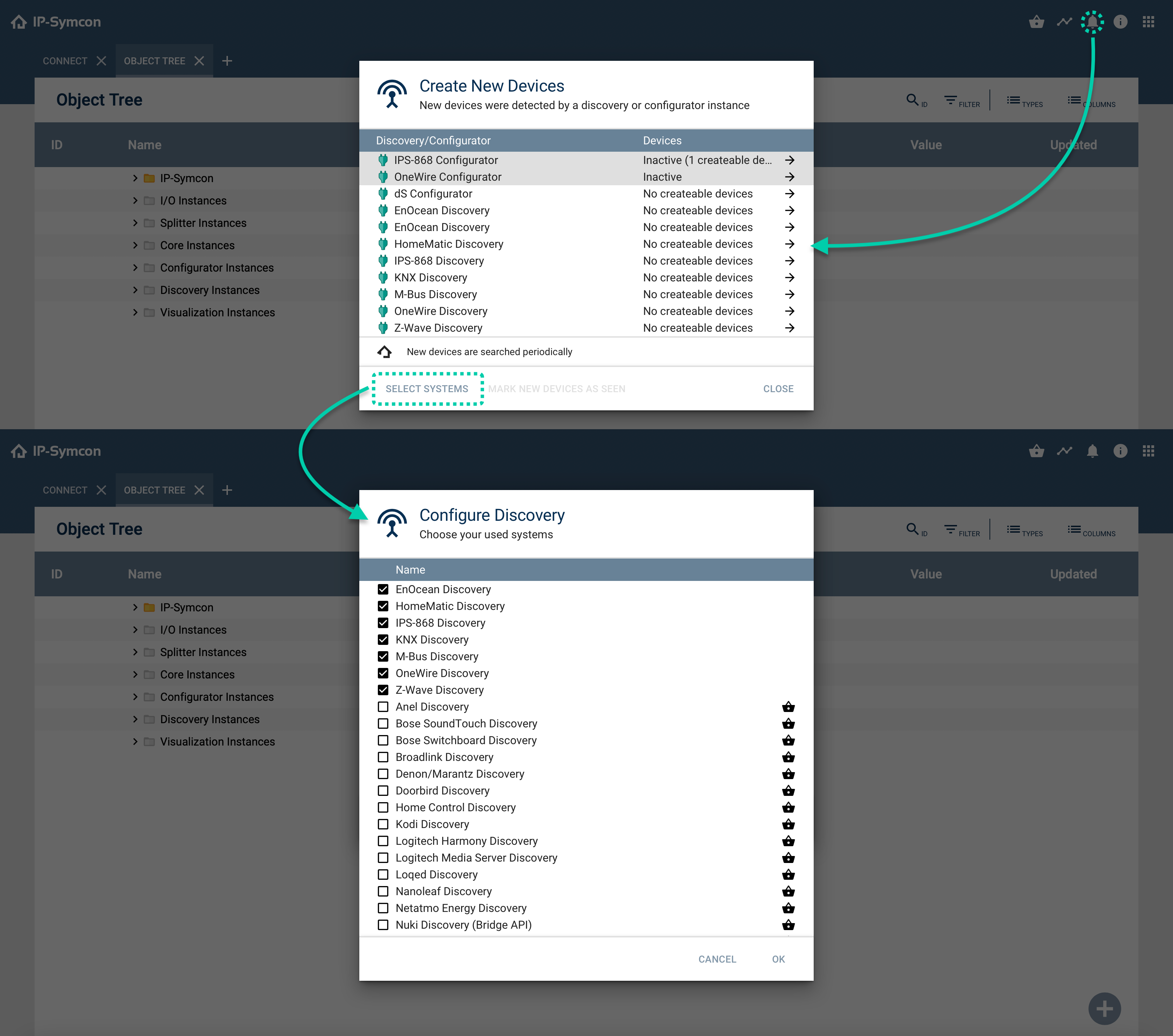

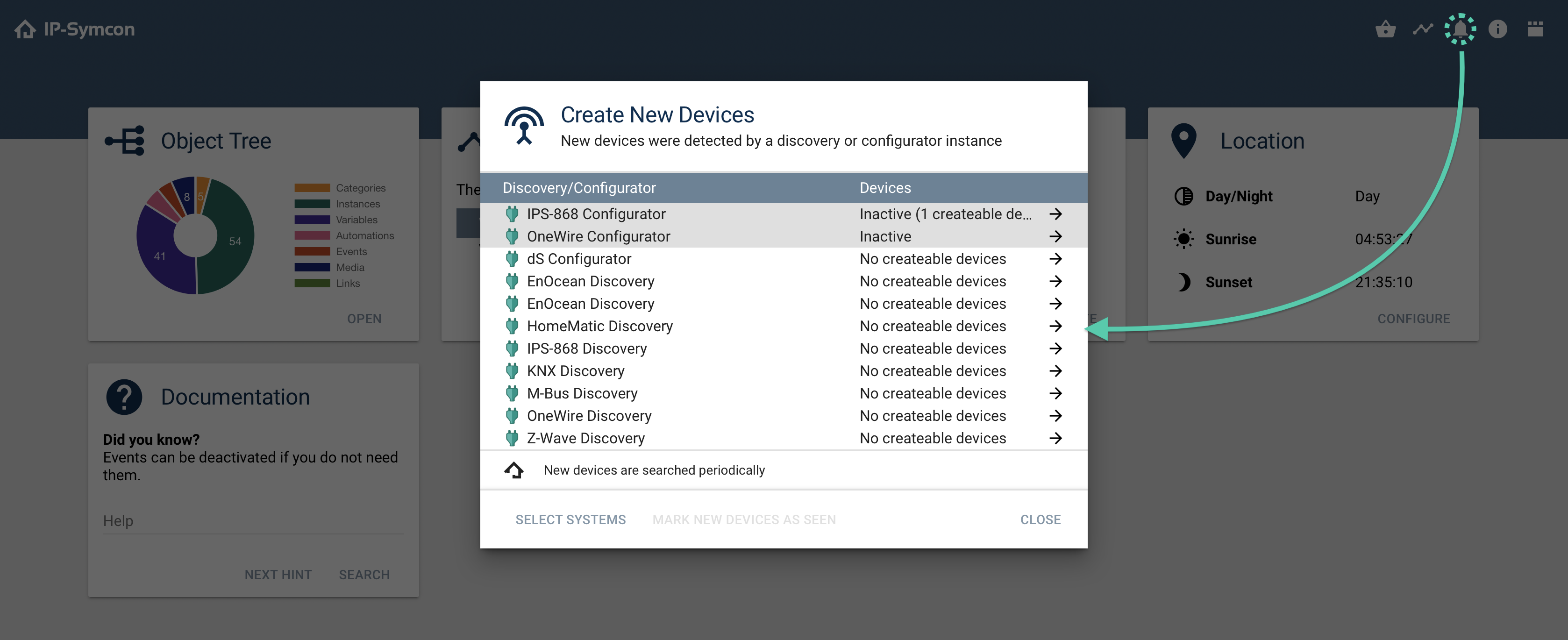

The Device Search button can be used to set up Discoveries and view Configurators. These provide information about newly connected devices and simplify the setup of new devices.
Set Up Discovery
The Device Search can be accessed via the bell icon at the top right of the console.
Initial Setup
Add Discovery

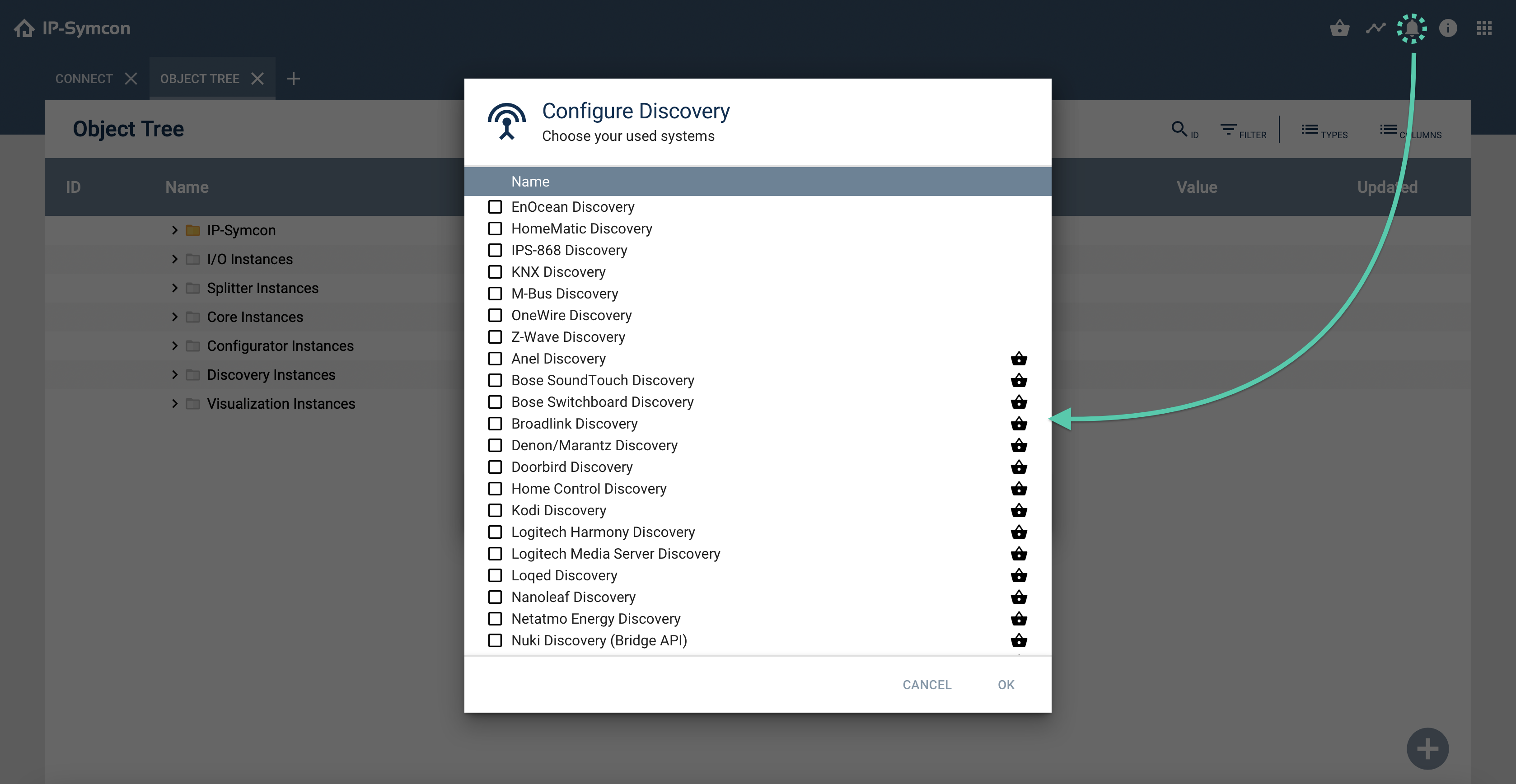

New Discoveries can be set up by ticking the box on the left side. If there is a basket on the right edge, it is a Discovery from the Module Store. These can be opened by clicking on the basket. When setting up a Discovery, the required IO/splitter instances are automatically created.
Additional Setup
Add Discovery
Additional Discovery Systems can be added via "Select Systems".
Open Device Search

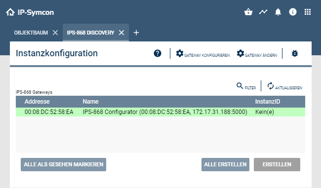

Configurators can be created and configured automatically using previously established Discoveries. The created configurators are displayed in the Device Search. The configuration for the established Discoveries/Configurators can be opened using the arrows on the right side.
Create a Configurator
System-specific Configurators can be created in the respective Discovery. To do this, the appropriate entry must first be selected from the list. Then "Create" has to be clicked. The Discovery automatically mirrors the complete configuration of the Configurator making it immediately functional.
Create Configurator
