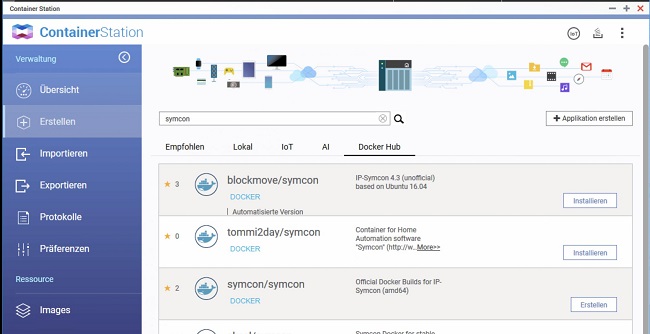

- Open Container Station
- Search for symcon/symcon in the Docker Hub and install/create the image (choose a tag, e.g., latest)

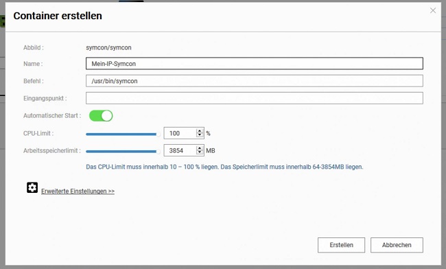

- Choose a name and open Advanced Settings

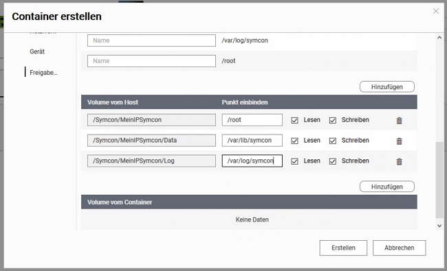

- Adjust Share Settings (/root, /var/lib/symcon, /var/log/symcon need to be stated!)

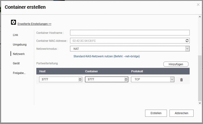

- Adjust Network Settings (3777 to 3777 TCP)
- Confirm with Create to create and start the container
