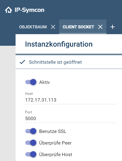

On the configuration page, the IP/ host name must be specified under "Host" and the port of the device to be controlled under "Port".
If SSL is activated, it can also be selected whether the host or peer should be checked.
Only a click on "Apply" saves the settings and then an attempt is made to establish the connection.
Configuration page
