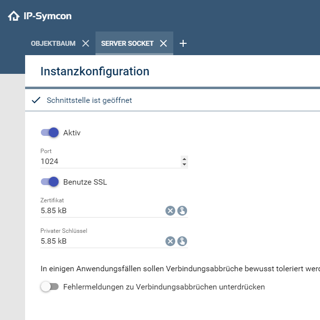

The server socket opens a port for all networks on the server. The port can then be listened on and data can be received on it.
Only a click on "Apply" saves the settings and then the port is opened.
If SSL is activated, the certificate and the private key must be specified.
Configuration page
Create certificate
Using OpenSSL, certificates and private keys can be created.
