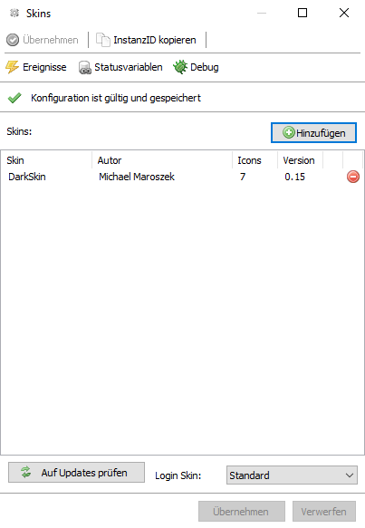

The "Skin Control" module offers the possibility to integrate individual skins or those provided by other users.
In the "Modules" instance ("Logical tree view"->"Core instances"), a Git repository link can be entered via "Add". Here, the skin is then installed and is immediately available.
The "Check for updates" button checks whether an update for already added skins is available. If an update is possible, the respective skin can be updated via the displayed update button. If a skin is up to date, a green tick is displayed instead.
Separate to the respective WebFront skins, which are selected in the respective WebFront configurator, the skin of the login area of the WebFront can also be changed. This can be set via selection in the skin control.
