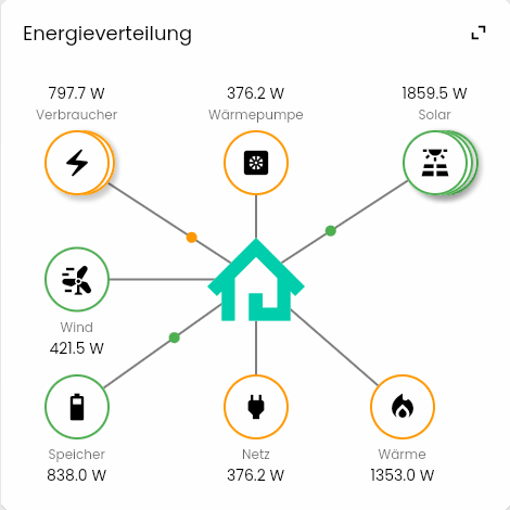

Layout
The house in the middle is fixed as the central point of energy exchange. The objects around it are arranged according to their position in the list above. The positioning is as follows:
- Top left
- Top right
- Bottom left
- Bottom right
- Top center
- Bottom center
- Left center
- Right center

Visualization

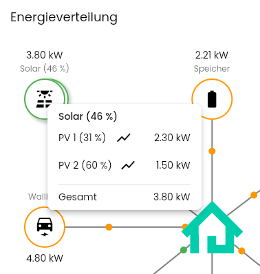

Each device and each group can be clicked to display a breakdown of the individual values. Once the selected variables have been logged, the corresponding diagram can be opened directly.
If required, a resource-saving mode can be activated by clicking on the house in the middle, which replaces the moving points with static arrows.
