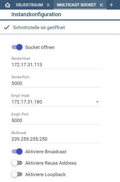

The multicast socket can be set up and activated on the configuration page.
Only a click on "Apply" saves the settings and then an attempt is made to establish the connection with activated "Open socket".
Configuration page
Send-Host/Port
IP and port of the device to be controlled.
Receive-Host/Port
Determines on which network and via which IP and port the data is received.
Multicast
Multicast group address that is logged on and obeyed.
Activatable Options
Option Description
Broadcast Allows broadcast messages to be sent
Reuse Address Allows the socket to be connected to an address that is already in use.
Loopback Activates the reception of Multicast-Packets on the send socket, provided this is a member of the Multicast Group.
