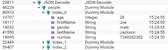

The JSON read in via the HTTP client is now processed with the JSON decoder and the following information is made available as variables in the object tree.
example
