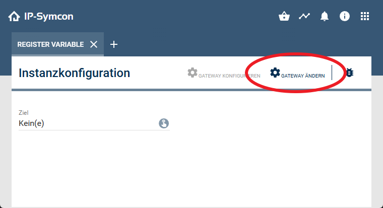

The RegisterVariable module connects automatically with a parent instance. You need to select parent instance or create a new one. You can also add another splitter (e.g. cutter) to synchronize the incoming data directly before evaluation.
The parent instance can be adjusted easily by using the function "Change Gateway" at the top of the configuration.
Change Gateway
