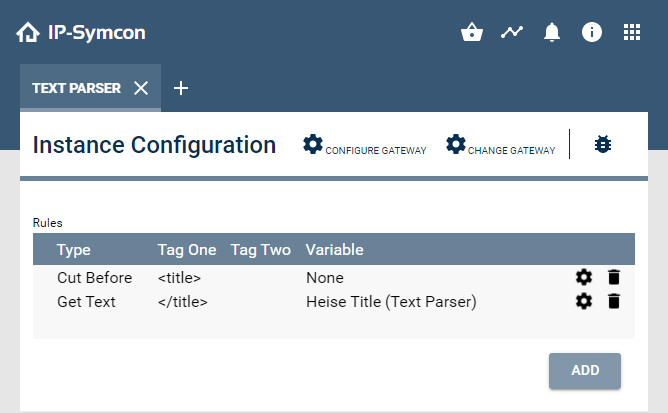

- In the Text Parser, the following rules need to be defined to read the title.
These rules can be deducted by looking at the HTML Code that is read by the HTTP Client. In the code, it should be searched for significant parts, that should be cut. This is repeated until the desired text remains. Those rules are the entered into IP-Symcon. - With "Get Text" a variable is defined where the completely cur text is saved.
Rules
| Description | Rule |
| Cut Text Before | <title> |
| Get Text | </title> |
Screenshot
