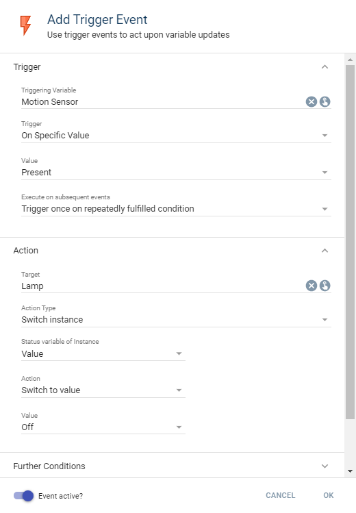

First, a triggered event is created. The motion sensor is defined as trigger on the value "Present" and the lamp is selected as target instance, switching its value to "On".
Add Event

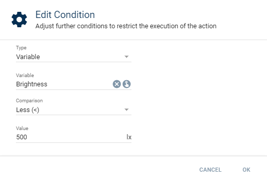

The light value "Brightness" is configured as "less" than 500.
Add Brightness Rule

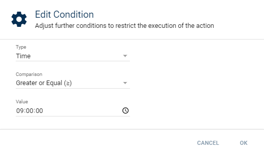

The time is configured as "greater or equal" to 09:00.
Add 09:00 rule

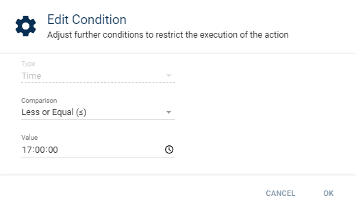

The time is configured as "less or equal" to 17:00.
Add 17:00 rule

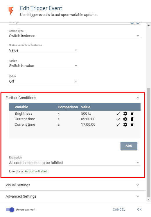

In the overview, all three rules are listed and the live state shows if the light would be switched on if the motion sensor would trigger at this moment.
Condition Rule Overview
