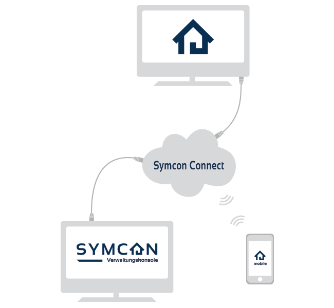

The Connect Control module offers the possibility to securely access the system from the outside. This connection can be used to manage the system from anywhere via the management console or to access it via the visualizations and mobile apps.
The measures mentioned under Security must always be taken in order to prevent unwanted access from the outside after activating the Connect module.
The module works completely without port sharing or setting up a DynDNS. A URL is automatically provided by our server. Thanks to secure tunneling, no special firewall settings are required and access within a company network is also possible.

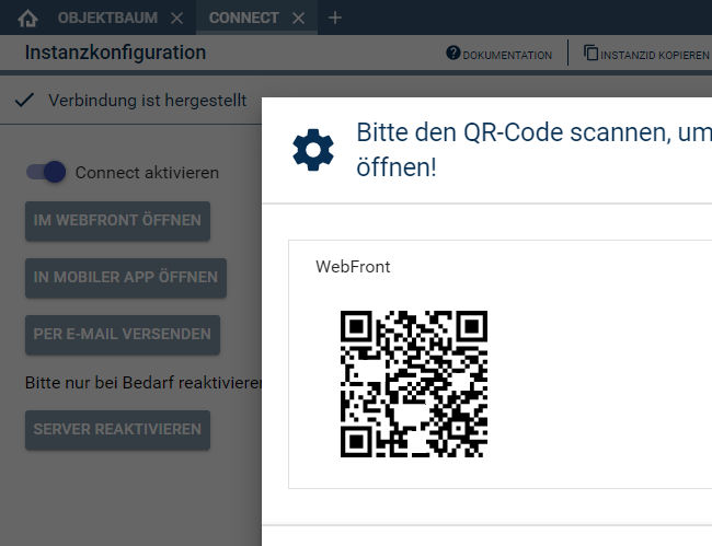

In the instance "Connect" ("Logical tree view" -> "Core instances") the module can be activated via "Activate Symcon Connect".
The following 3 access methods are available:
"Open WebFront"
This opens the personal URL in the web browser, which has the following format (http://32-figure-lettersequence.ipmagic.de). The WebFront can now be accessed from anywhere using the address shown in the address bar. This can be entered in any browser and on any smartphone. An encrypted connection is then established.
It is recommended to secure the WebFront with a password.
"Open on smartphone"
The address can be read in on mobile devices via QR code. (Any QR code reading software is required for this. As of iOS11, scanning can be carried out directly via the integrated camera app.) In the QR code, the link is formatted in the form of a WebFront Share Link and thus automatically opens the required IP-Symcon app, including the selected WebFront.

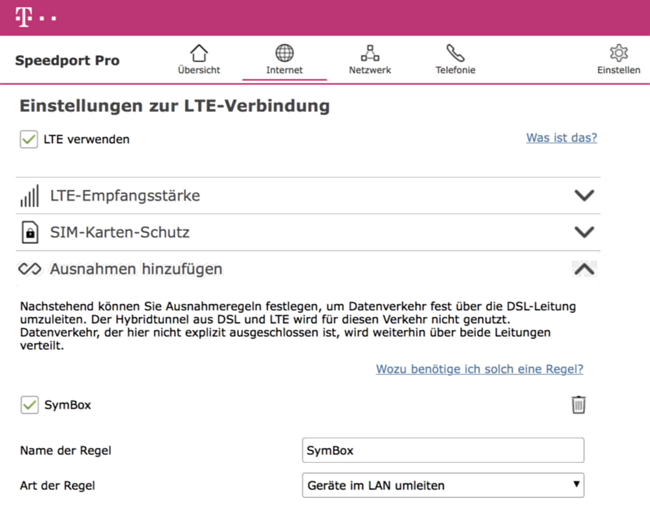

Telekom with DSL and LTE
For Telekom customers using a hybrid DSL+LTE solution, an exception should be created for the SymBox or the IP-Symcon service so that it only communicates via DSL.
Telekom Settings
