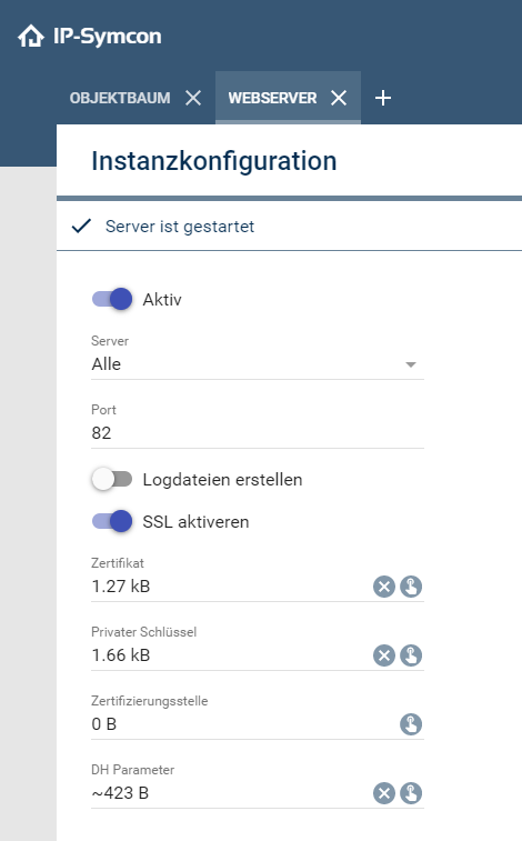

SSL Encryption
To use SSL, at least the certificate and the private key are required.
Option Description
Certificate Selection of the *.pem file containing the certificate
Private key Selection of the *.pem file containing the private key
Certification body
(optional)
Selection of the *.pem file which contains the certification authority for a trusted access
DH parameters
(optional)
Select the dhparam.pem file for the Diffie-Hellman parameter which prevents a logjam. This brings increased safety
