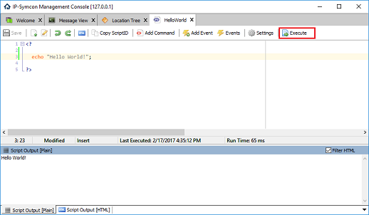

A PHP script is required to begin with a PHP Tag (<?php). Every command needs to end with a semicolon.
![Hello World Example](/media/pages/service/dokumentation/grundlagen/automationen/php-skripte/d5adcecad0-1721983697/script-hello-world.png)
The PHP script can be executed manually via "Execute".
In that case, the execution is saved automatically. The time stamp of the last execution as well as the runtime are updated. The view can be changed between [Text] and [HTML].

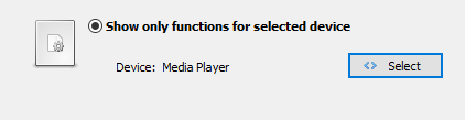

To handle the multitude of commands, it is recommended to select the affected device.
Here is an example for the sound output "Media Player":
![Example](/media/pages/service/dokumentation/grundlagen/automationen/php-skripte/02f5a160bf-1721983697/script-add-command-2.png)

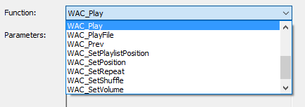

A selection shows all device specific functions:
![Example](/media/pages/service/dokumentation/grundlagen/automationen/php-skripte/899160a3cc-1721983697/script-add-command-3.png)

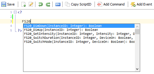

Autocompletion can be used when entering commands by pressing "Ctrl + Space" within a PHP script. The shown list contains all IP-Symcon functions. The selection can be narrowed by entering the first letters of a command. For example, typing "'f' + 's' + '2' + '0'" shows all FS20 commands. The wanted command can be chosen by double click or via arrows + Enter.
