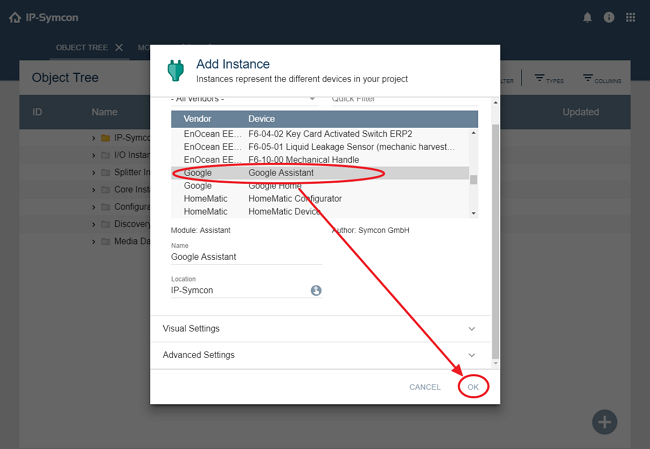

If the instance should be added manually, an Instance of the Google Assistant module needs to be created. This is done by opening the Object Tree. Here, the add button "+" at the bottom right needs to be clicked and Instance selected.
Add Instance
In the module list, select the device "Google Assistant" or "Google Home" from the vendor "Google". The location should not be changed. The name can be chosen at will. Finally, confirm with "OK".
Create Instance

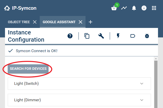

The module offers multiple device types that can be used. Especially the initial setup can be sped up significantly by using the Device Search. Later on, additional devices can easily be added manually.
The Device Search is started by clicking the button "Search for Devices" at the top of the instance configuration.
Open Device Search

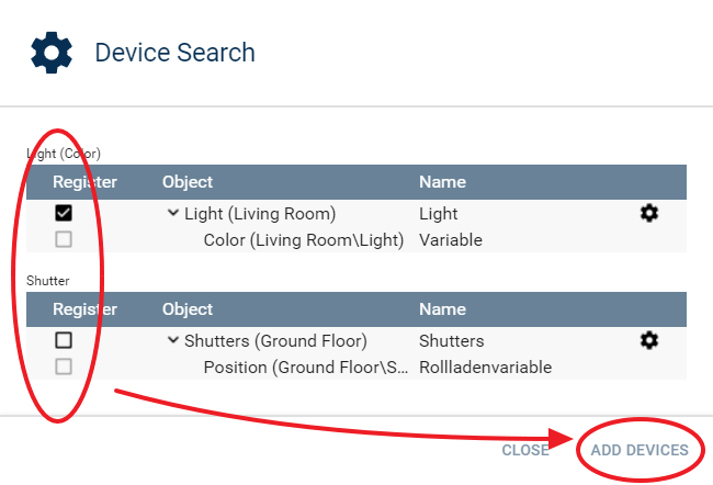

Then, a dialog is opened. After a loading time, found devices that are not yet implemented into Alexa are shown. These instances are seperated by device type. Below each instance, the status variables that are used upon implementation are shown. If an instance should be implemented, the check box at the beginning of the instances row must be checked. By default, the name of the instance is used. If it should be updated, the "Edit" button at the right of the list entry can be clicked. After all desired instances are selected and eventually their names updated, the selection is confirmed by clicking "Add Devices". Then, the selected devices are added to the respective lists in the instance configuration.
Select Devices

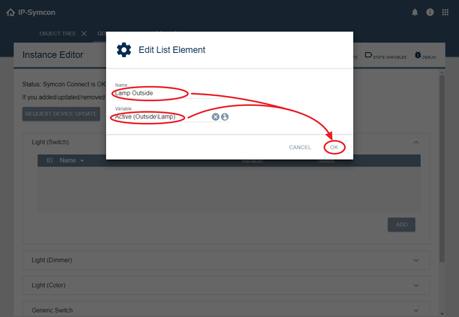

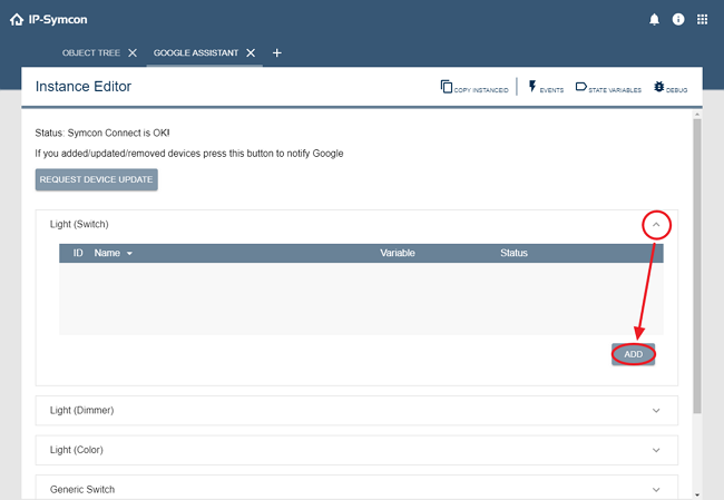

To prepare a device manually, expand its panel and create a new entry in its list by clicking "Add" below the list.
Add Device
Each entry requires a name, under which the device will be known to Google Assistant. Additional parameters depend on the device type and can be found in the corresponding site of the documentation. After setting all parameters, confirm with "OK".
Configure Device

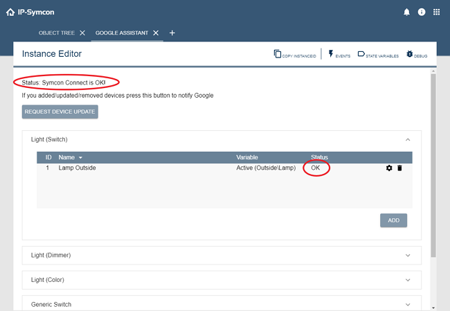

After all devices are configured, confirm the settings by clicking "Apply Changes".
Apply Changes
After applying, it is recommended to check that the column "Status" contains "OK" for all devices. If this is not the case, the column contains an error message that contains further information about the complication.
It should also be checked that the label at the top of the instance states "Status: Symcon Connect is OK". Otherwise, the Connect Service needs to be activated.
Check Status

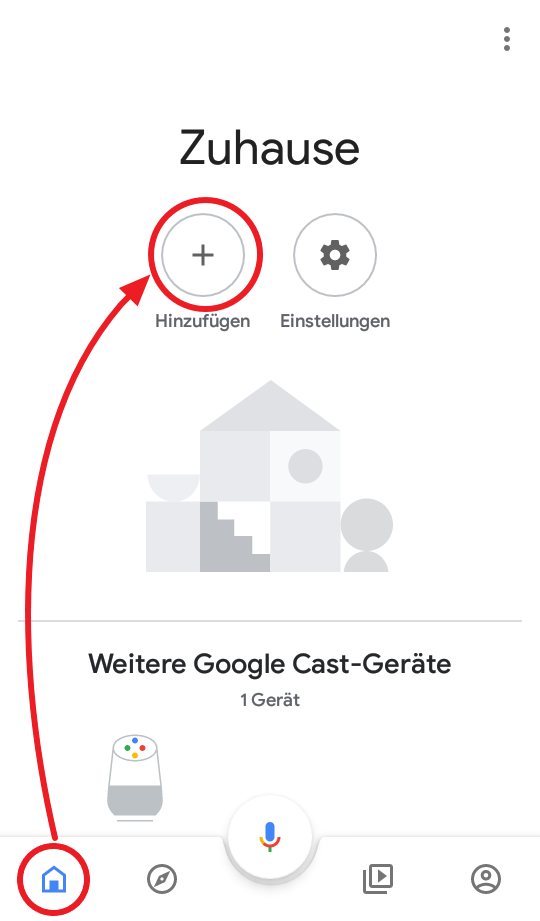

The installation is done with the Google Home app.

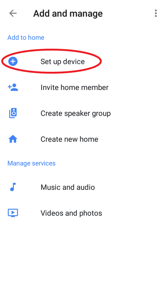

Within the app, select the home control tab at the bottom left and tap on "Add".
Home Control
Tap "Set up device" in the menu.

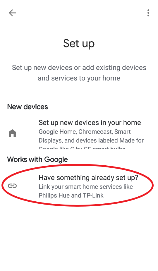

Tap "Have something already set up?".

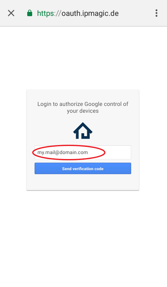

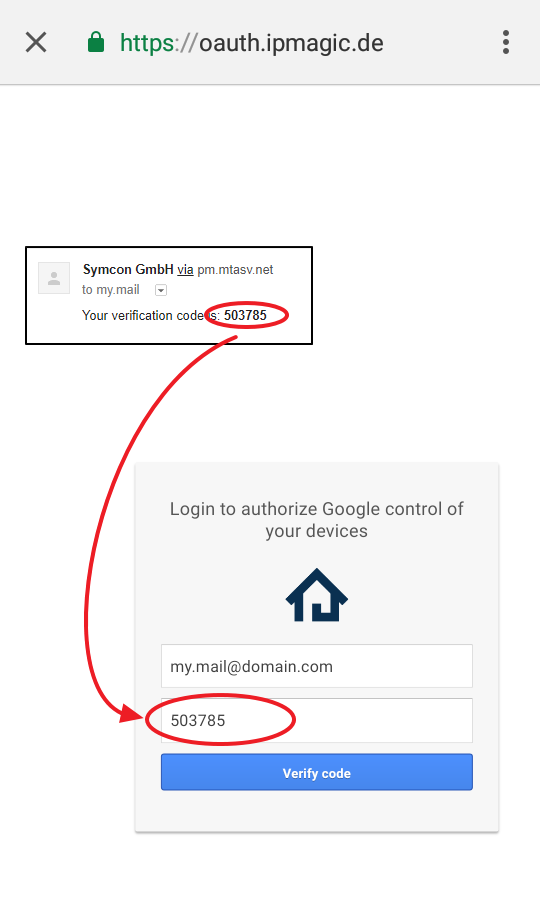

Enter the e-mail address, that the IP-Symcon is registered to, in the popup and confirm with "Send verification code".
Enter E-Mail
An e-mail with a code is sent to the provided e-mail address. Enter the code from the e-mail into the popup and confirm with "Verify code".
Enter Code

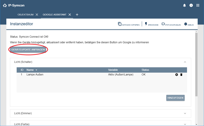

After successful confirmation, the prepared devices appear in the Google Home app and can be used.
Request device update
