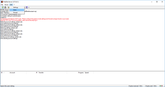

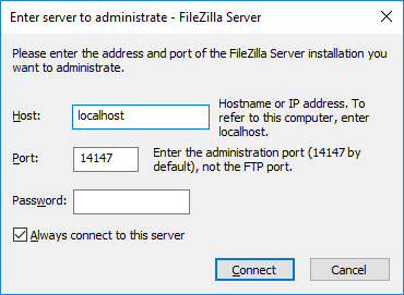

Connect to Server
When launching the tool, the shown dialog is opened. It is used to connect to the created FTP server. If the default settings from the installation were used, the data can be used as shown in the screenshot, i.e., "Host": "localhost", "Port": 14147, and no password.
In most cases, the firewall needs to be configured to allow access to the FTP server. The process is explained for Filezilla here

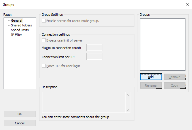

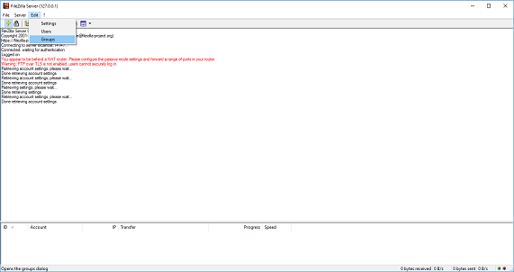

Creating a Group
The next step is setting up a group for users. Groups can be used to categorize users and provide different rights or accessible folders. However, it is also possible to simply create a single group that is used for all users, thus providing the same rights to every user.
Edit -> Groups

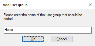

Add Group
Select Group Name
The Groups settings can be accessed via the menu "Edit->Groups". In the shown dialog, a new group can be added via "Add" below the initially empty list of groups. After entering a name and confirming the choice, a new group is created.

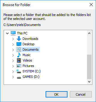

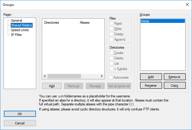

Add Shared Folder
Select Folder
In the category "Shared folders", the folder that is meant to be accessed via FTP is chosen by clicking "Add" below the initially empty list of directories. This will open a dialog to select a folder.

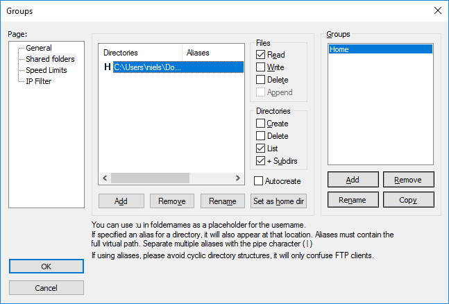

Configure Rights
After adding a shared folder, it is possible to configure the rights of accessing the folder. By default, the files in the folder and its subdirectories can be read but not modified.

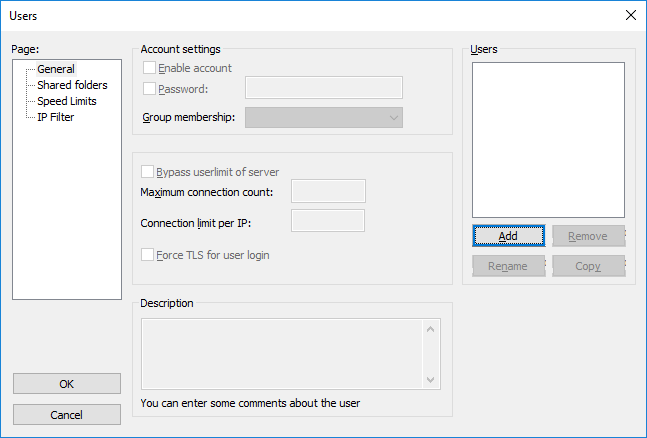

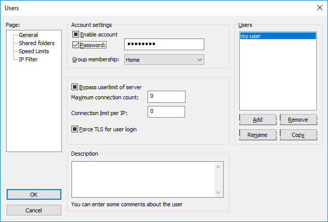

Creating a User
Edit -> Users
Add User
Choose User Name and Group
New users are added in the Users settings that are accessed via "Edit->Users". A new user is added by clicking "Add" below the initially empty list of users. In the shown dialog, a user name and a group is chosen. After confirming the choice, the user is added.
Set Password
A password can be set for the newly created user by activating the checkbox "Password" and entering a chosen password.
If only one user exists, the creation of a group can be skipped. Instead, the user is assigned a shared folder directly.
