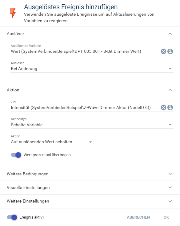

In the object tree, the two device instances have already been created and are functioning properly on their own. Now an event must be created. To do this, an event can be added via the "+" at the bottom right of the object tree.
The event must be configured as follows.
The dimming value, whose value is to be transferred on change, is selected as the triggering variable. In this example it is the value of DPT 005.001.
Under Action, the intensity of the Z-Wave lamp with dimmer actuator is selected as "Target". As action type "Switch variable" and as action "Switch to triggering value" must be selected.
By clicking "OK" the event is created and the configuration is saved.
event configuration

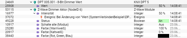

From now on, every time the KNX dimmer value changes, the intensity of the Z-Wave instance will be dimmed to the same value.
The object tree should then look like this.
object tree
