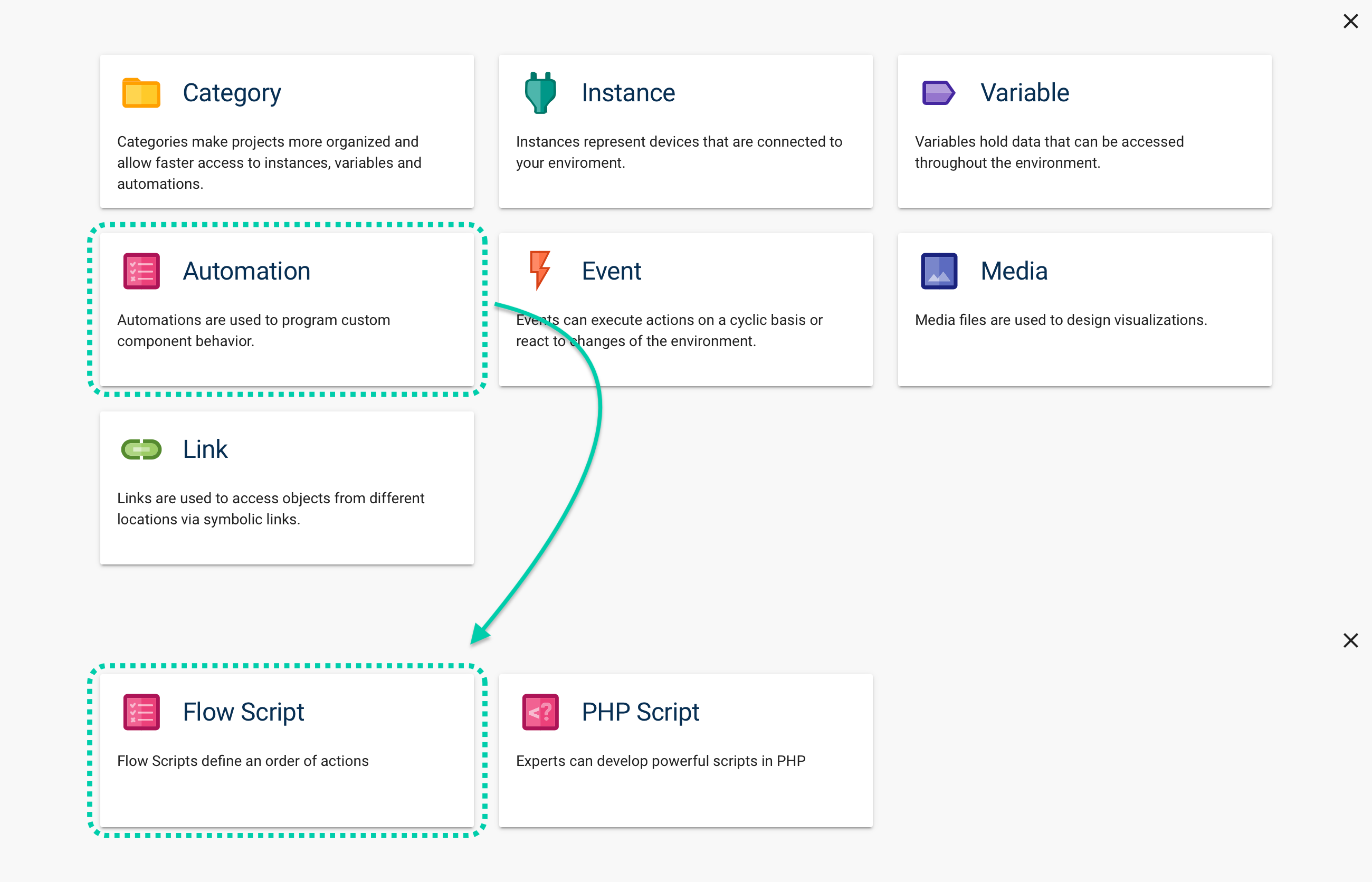

Add Flow Script
A new flow script can be added via "+" -> "Automation" -> "Flow Script". It is recommended to give the flow script a unique and meaningful name.
The name can be changed at any time and the flow script can be moved within the tree view via Drag & Drop. Alternatively, the flow script can be directly created at the wanted position via "Right click" -> "Add Object" -> "Automation" -> "Flow Script".

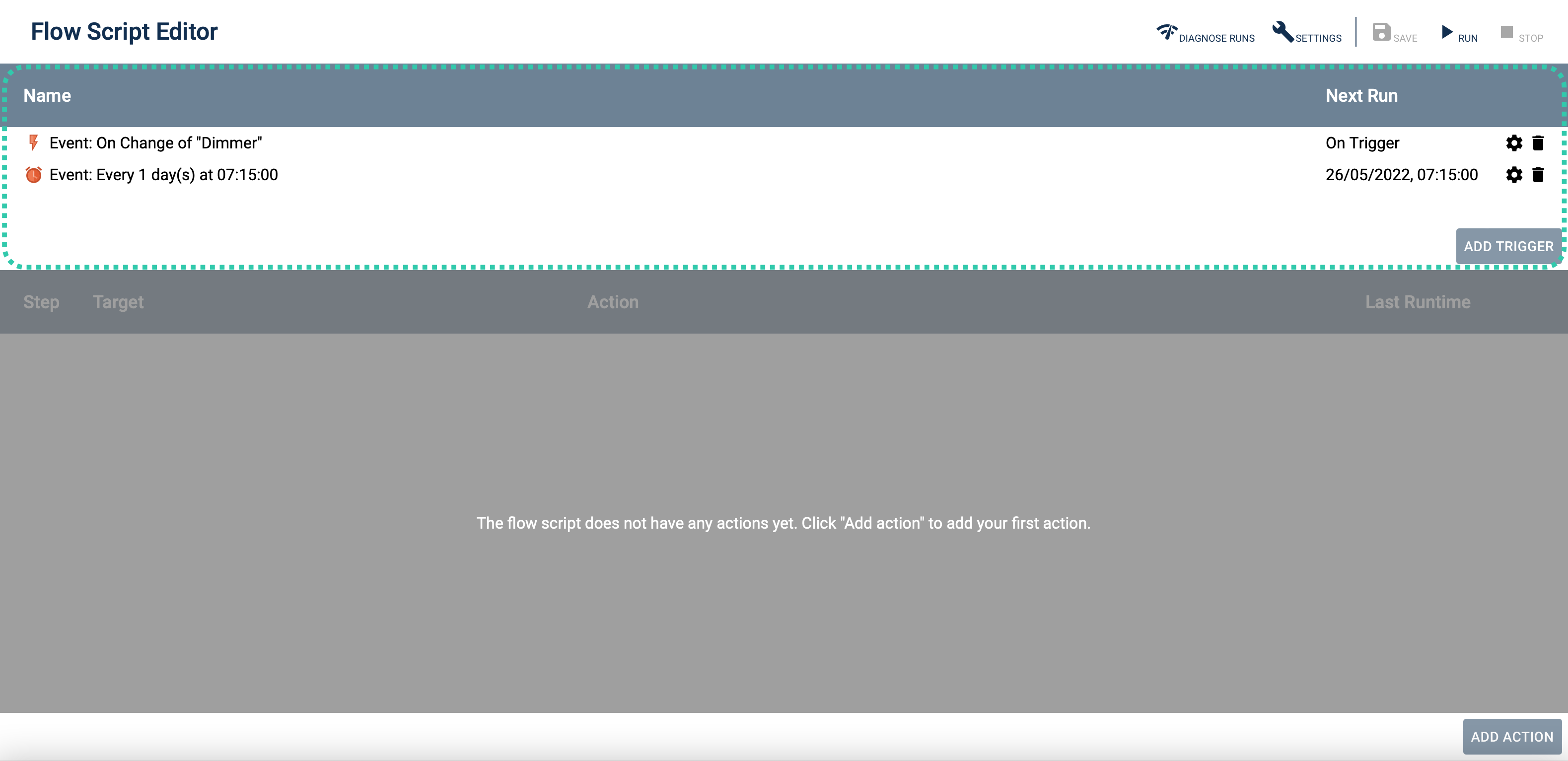

Add Trigger
A trigger is an event and defines when a flow script is executed. The specific configuration is explained at Events.
| Column | Description |
| Name | The name of the trigger in the object tree |
| Next Execution | When or how the trigger is triggered |
| Gear | Open the configuration for the trigger |
| Garbage Bin | Delete the trigger |

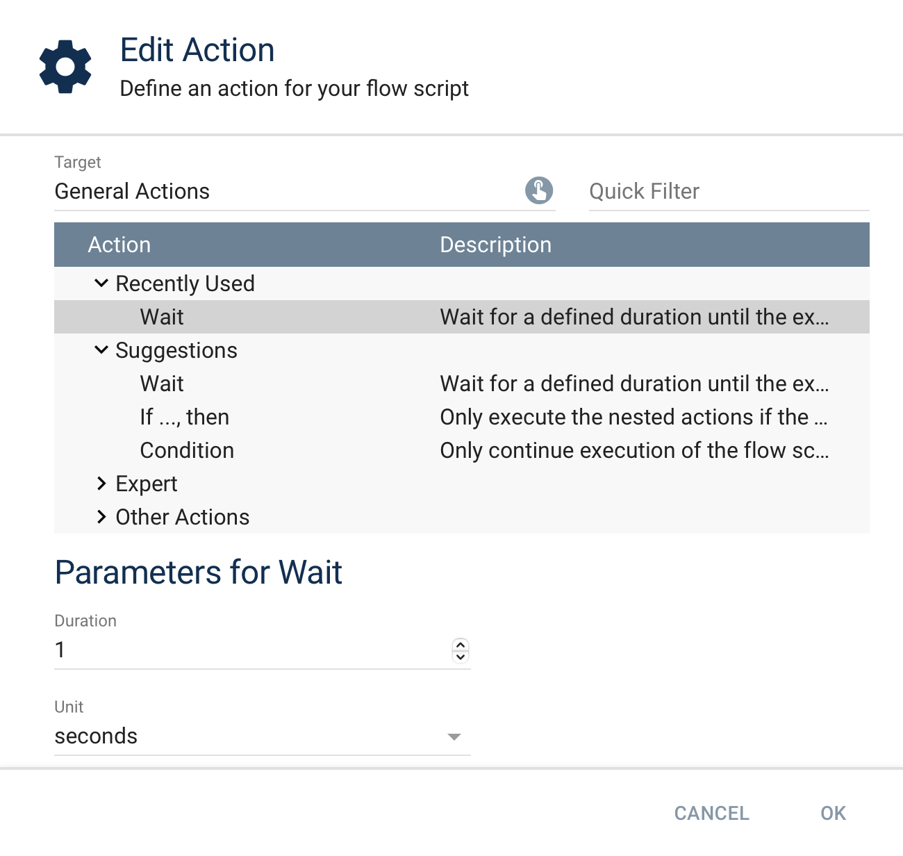

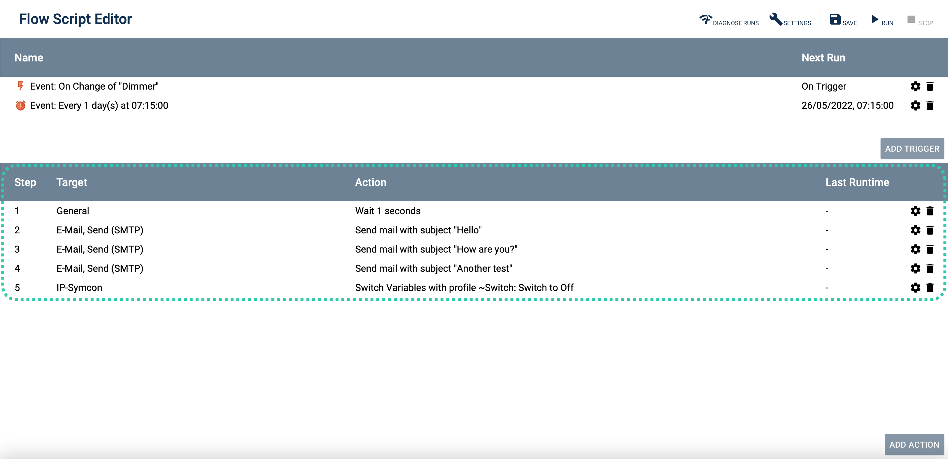

Add Action
An action is specific for a selected target. An action can trigger a multitude of processes, e.g., switching a device, a condition for further subactions, or a break in the flow that is continued after some time. As such, complex processes can be constructed without a single line of source code.
| Step | The position of the action within the flow script. Some actions have substeps |
| Target | Displays the target of the action. It can be an object or a general action, e.g., waiting or a condition |
| Action | A description of the action to be executed |
| Last Runtime | The runtime of the step during the last execution of the flow script |
| Gear | Open the configuration of the action |
| Garbage Bin | Delete the action |
If a red exclamation mark appears in the list, the last execution was erroneous. The error message can be displayed with a click on the exclamation mark.
