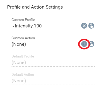

The action script needs to be linked to the corresponding variable as "Custom Action".
Special variables for called scripts are shown in System Variables.
An action script can be used by multiple variables. The most common variant is shown below: "Set Variable only".
Select Action Script
The selection of an action script is the same as the selection of a Variable Action .
Some variables of added modules contain a "Default Action". It can be overwritten by a "Custom Action".
Selecting an Action Script

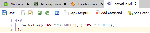

Create Action Script
An action script is a regular script file. It becomes an action script by linking it to a variable.
An action script should describe the switching process or at least a command that sets the variable to the requested state:
Example 1
//Set Variable only
Example 2
//Set variable accordingly when switching was sucessful
if (FS20_SwitchMode(12345, (boolean)$_IPS['VALUE'])) {
Content of an Action Script
