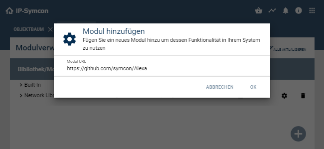

The modules can then be added directly to the Module Control via the repository URL. It is also possible to submit this module for the Module store.
Add repository
