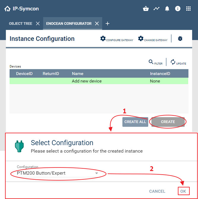

The configurator can create any EnOcean device as instance. This is done by selecting "New device", clicking "Create", and selecting the according device from the list.

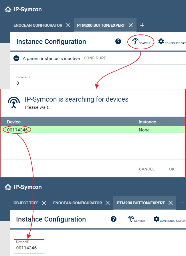

After the configurator has created the instance and the configuration button was pressed, the configuration for the device instance opens. Here, the Device ID can be searched and selected by pressing the "Search" button and multiple confirmations on the EnOcean device.

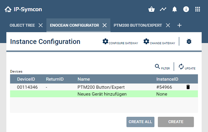

![EnOcean Configurator](/media/pages/service/dokumentation/modulreferenz/enocean/cfa2d8559b-1721983698/enocean-configurator2.png)
New instances are created in the main category in the Object Tree. These created instances can be renamed and positioned at another location. It is also possible to open the corresponding instance configurations via "Configure" in the configurator.
