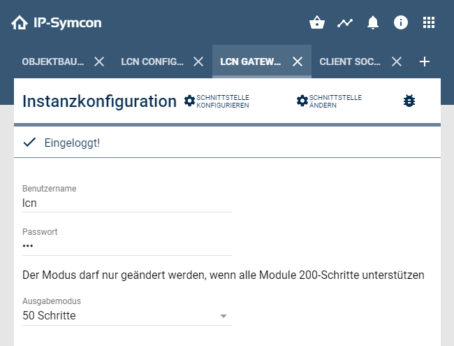

After a configurator has been created, a red message may appear. This indicates an incorrect or incomplete configuration. To correct the error, the user name and password must be specified in the parent instance. The change is saved by clicking on "Apply".
LCN: Logged-In
If it is not possible to log in after applying, the network configuration within the interface must be checked. Also, in the gateway, the output mode can also be selected between 50 and 200 steps.

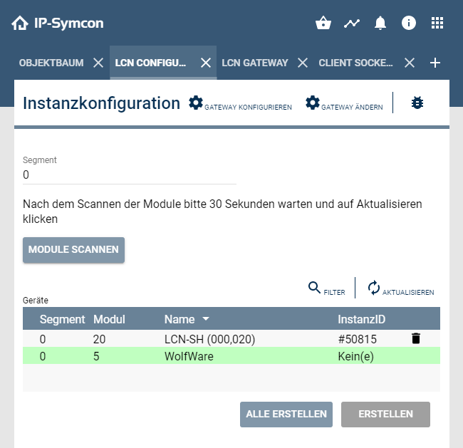

After successfully logging in, modules can be searched for on the bus in the configurator, created in IP-Symcon and the individual modules can be created as IP-Symcon splitter instances.

Configuration page (Gateway)
Name Description
Username Username for the login at the LCN gateway (PCHK or Ethernet coupler)
Password Password for the login at the LCN gateway
Require Acknowledgment Recommended for good reliability
Output-Mode 50 steps or 200 steps. Only change it if all modules support 200 steps

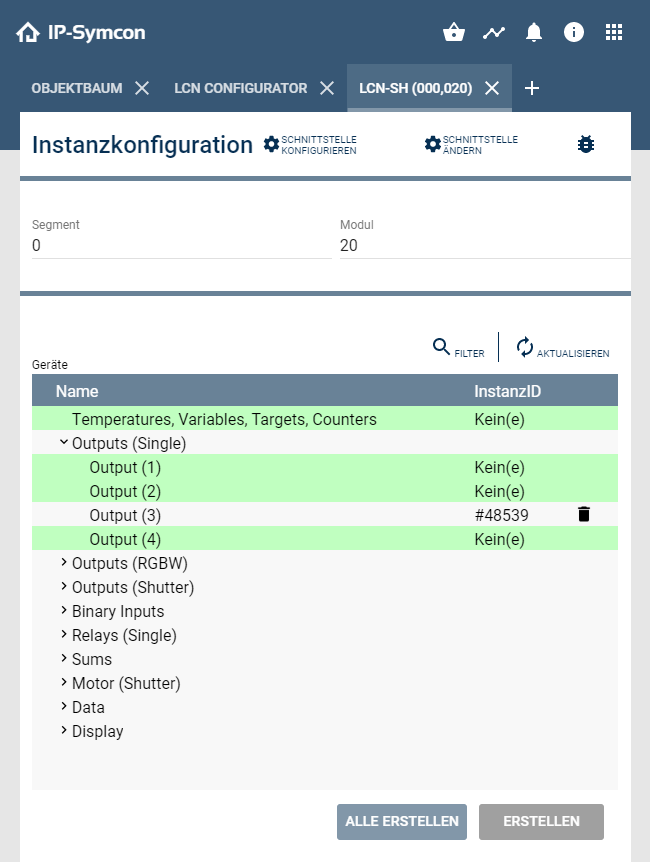

In order to create the individual instances, the desired relays, inputs/outputs, etc. must be selected and "Create" must be clicked on.

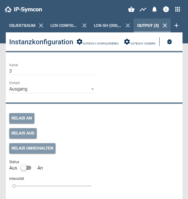

New devices are created and sorted within the object tree into the category that matches the name of the module. These created instances can then be renamed accordingly and sorted elsewhere. It is also possible to call up the respective instance configuration via "Configure".
LCN: Instance-Configuration
