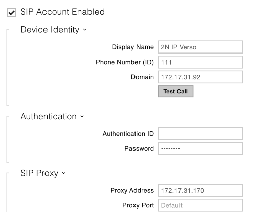

  • Domain: The IP address of the 2N
  • Proxy address: The IP address of the Symcon server
  • Display Name and Phone Number can be freely selected.

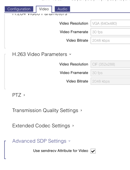

  • Use sendrecv Attribute for Video: Activated

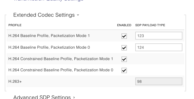

  • The codec settings must be set as follows

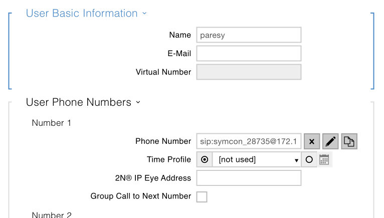

  • User Phone Numbers → Number 1: UserNameFromIntercomInstance@IPfromSymconServer:5060
    • In the example: sip:symcon_28735@172.17.31.170

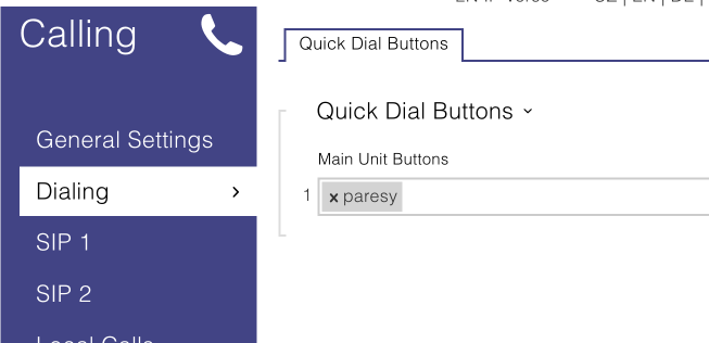

The previously configured user must be called when the bell is pressed.
