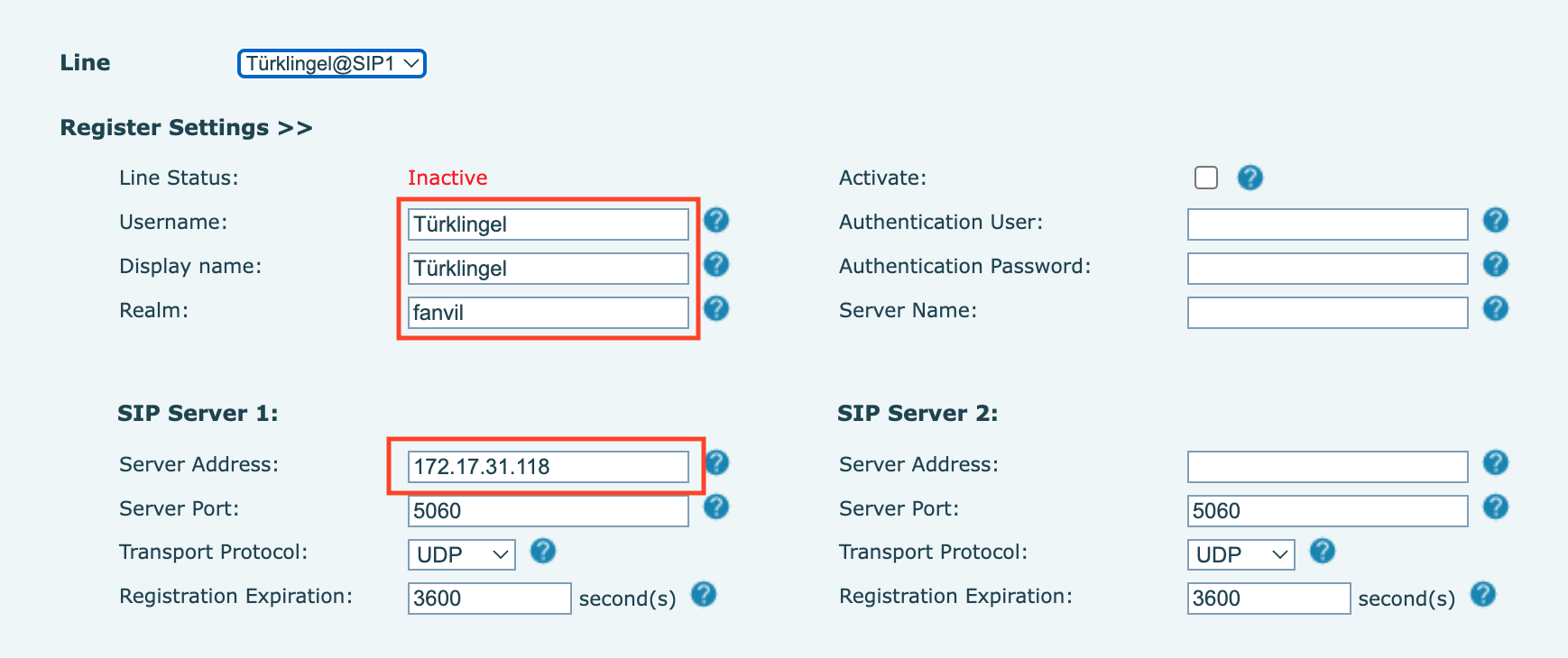

Username/Display: Can be freely selected
Server Address: The IP address of the Symcon server

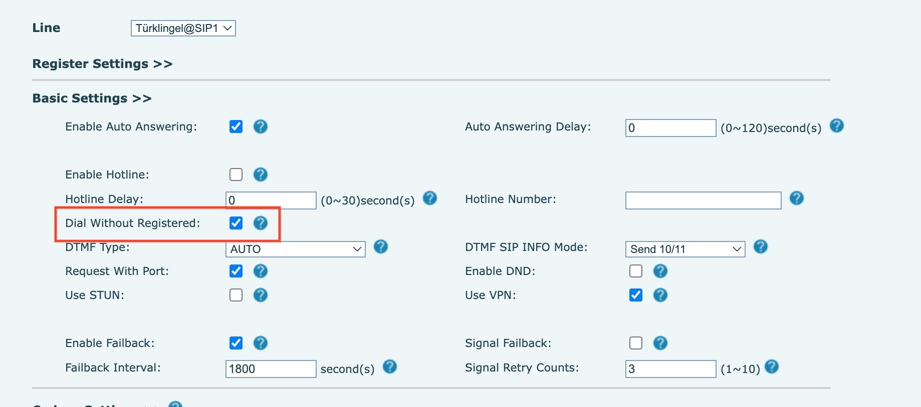

  • Dial Without Registered: Activated

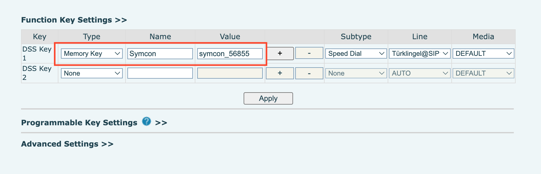

Function Key Settings
  • Type: Memory Key
  • Name: Can be freely selected
  • Value: User name in the Door Intercom instance
