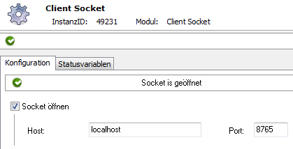

  • Host: localhost
  • Port: 8765

A successful installation can be seen at the open socket.
WinLIRC: Socket
