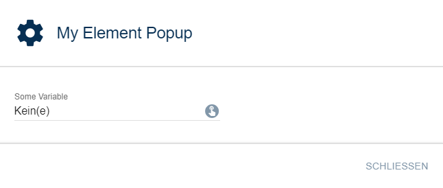

Beispiel
            "type": "PopupButton",
            "caption": "Open Popup",
            "popup": {
                "caption": "My Element Popup",
                "items": [
                        "type": "SelectVariable",
                        "name": "VariableTest",
                        "caption": "Some Variable"
