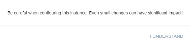

Beispiel
    "type": "PopupAlert",
    "popup": {
        "closeCaption": "I understand",
        "items": [
               "type": "Label",
               "caption": "Be careful when configuring this instance. Even small changes can have significant impact!"
