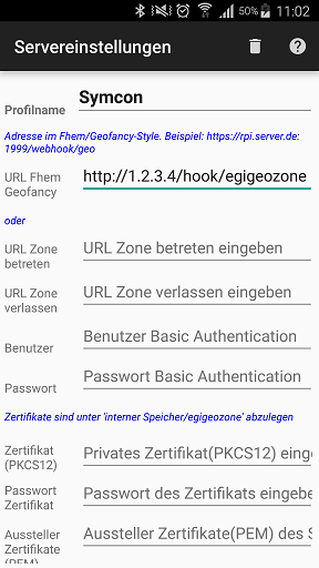

Configuration Page:
| Name | Description |
| Username | Username which must be specified in the EgiGeoZone App to send IP-Symcon data. |
| Password | Password which must be specified in the EgiGeoZone App. |
*If this data is left empty, anyone can send data to IP-Symcon via the hook

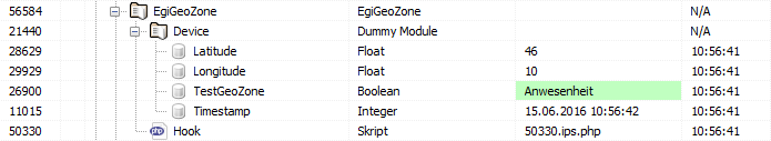

Status variables
The variables are created automatically based on the device ID and when sending within the EgiGeoZone module for the first time. Multiple devices can run through one hook. Each device is set up under its own "category".
| Name | Type | Description |
| Device Name | Instance (Dummy) | Serves as a "category" in which all monitored locations, as well as the timestamp and longitude/latitude are located. Created per device. |
| Latitude | Float | Latitude of the last activity. |
| Longitude | Float | Longitude of the last activity. |
| Timestamp | Integer | UnixTimestamp of the last activity. |
| Sample Location (GeoZoneTest) | Boolean | Present or Absent. Information supplied by Gefency. |
