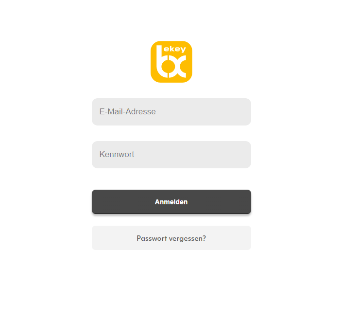

The instance is then created. The message "A higher-level instance is inactive" appears in the configurator. The ekey Cloud instance is called up. To complete the setup of the ekey Cloud instance, click on the Register button. A new tab opens in the browser with the ekey login screen.

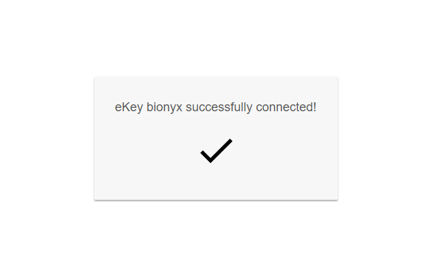

After entering the login data, the following dialog is displayed if successful.
You can now return to IP-Symcon. A token should now be available in the ekey bionyx Cloud instance.
