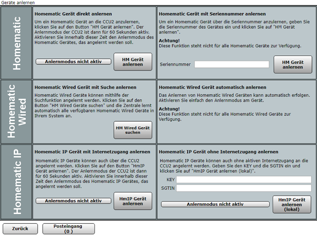

In the HomeMatic WebUI, the secondary HomeMatic devices (e.g. temperature sensors, intermediate plugs, handheld transmitters, etc.) can now be connected to the CCU. To do this, "Teach devices" (top right) must be clicked on and the further instructions followed.

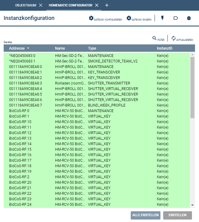

The CCU can be integrated via the Device Search. For this, "Homematic Discovery" must be selected as the system. The Discovery instance then offers to create a Homematic Configurator. After the configurator has been created, the individual devices can be integrated via it as described below.

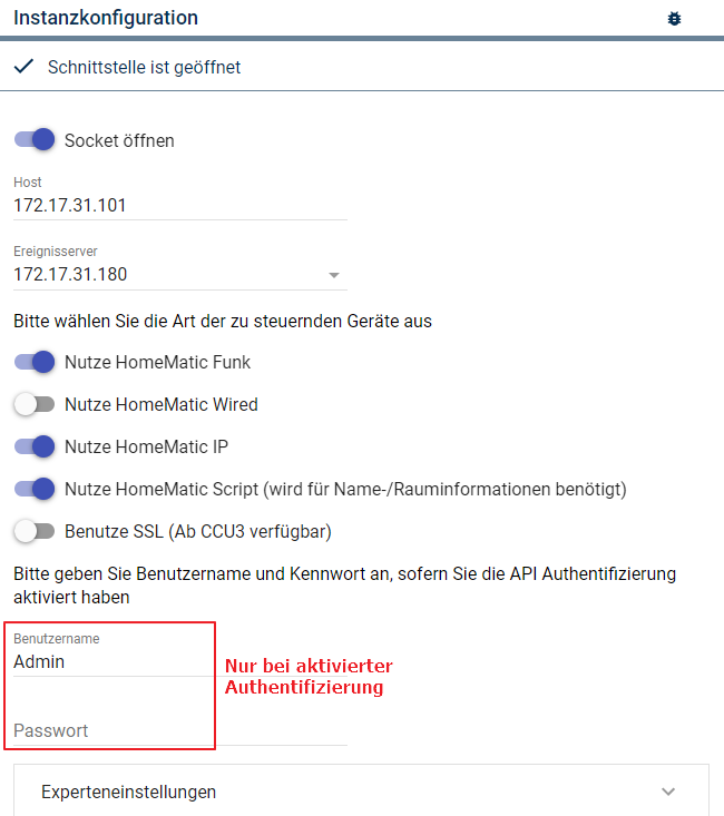

Within the configurator, the configuration page of the "HomeMatic Socket" can be opened via "Configure gateway". To activate the socket, the checkbox "Open socket" must be set. The options displayed tell whether HomeMatic radio/wired/IP is to be used. If authentication is enabled, the user name and password can be entered here.
Various devices are now visible in the window that appears in the center. After selecting a device, a device instance can be created with "Create" and then the configuration page can be called up via "Configure".

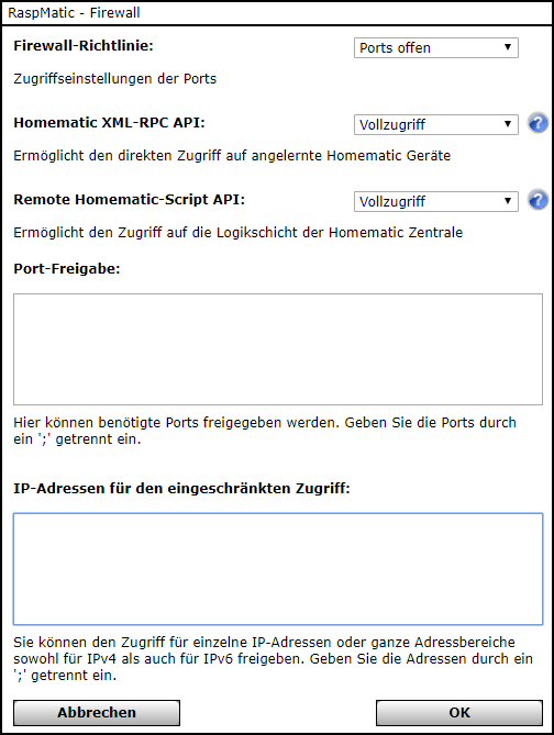

Another way to ensure the functionality of the return channel is to make sure that under the firewall settings in the CCU "HomeMatic XML-RPC API" and "Remote HomeMatic-Script API" full access is selected or the IP address of the IP-Symcon PC is entered.

It is recommended to use the HomeMatic Configurator to set up the individual devices.

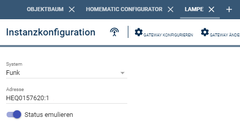

The following settings are possible on the configuration page of the device instance.
| Option | Description |
| System | Select whether the device is controlled via radio, wired or IP. |
| Address | HomeMatic Address of the device. This can also be searched for via the "Search" dialog in the upper bar of the configuration bar. |

Authentication is possible with a CCU3 or RaspberryMatic in combination with IP-Symcon 5.1 or above.
This can be set in the web interface of the CCU. Authentication can be activated under "Settings" -> "Control Panel" -> "Security". This then uses the users that are set in the user administration.
Furthermore, the firewall can be set up under "Settings" -> "Control Panel" -> "Configure Firewall". Further information can be found in the CCU manual.

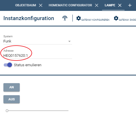

For replacement, the configuration of the defective device must be opened in IP-Symcon and the address of the old device must be replaced for that of the new one. The address is either on the device itself or can be selected via "Search".
The address in the highlighted area must be replaced and saved with "Apply".
