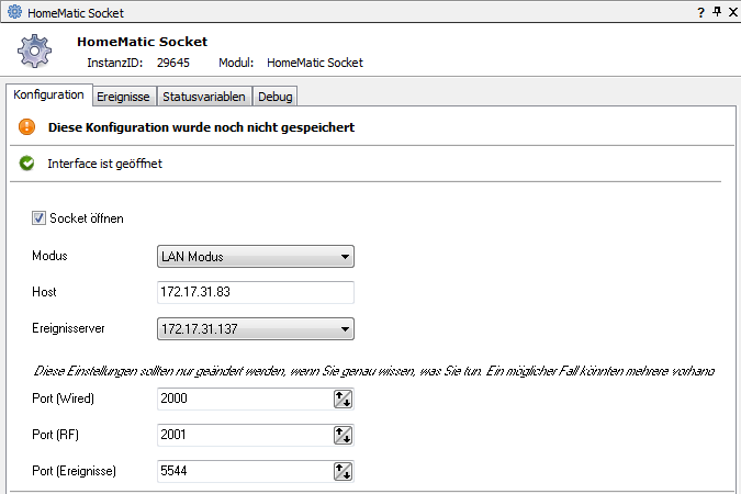

Client Socket in IP-Symcon
The HomeMatic Socket (in the I/O instances) must be configured. "LAN Mode" must be selected as the mode. If the BidCoS service is running on another PC, its IP address must be entered as the host. Otherwise "localhost" must remain specified as the address. If there are several network adapters, the IP address of the network-adapter, which the LAN-adapter is connected to, must be selected in the event-server. The port (5544) does not have to be changed, it only has to be enabled in an existing firewall.
HomeMatic-Socket 2
