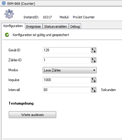

Now add a new EKM 868 (manufacturer: IP Symcon/ ProJet):
| Value | Description |
| DeviceID | Default 128 is predetermined. When two EKM 868 are present in a system, in the device a jumpers can be set: the two lower pins (direction Header, upper PIN: NC). The new ID is then 129. ATTENTION: If red LEDs are installed (1 to 4), the ID is 129 by open Jumper! Devices with the ID 130/131, etc. are available on request. |
| CounterID | The ID corresponds to the respective inputs (channels): 1,2,3,4 |
| Modus: Read counter | It is read out the count (Variable: Counter) and the time interval in 1/100 seconds between two impulses (Current). |
| Modus: Read on-time | The duty cycle (closed contact) is returned in 1/10 seconds (at 32 bits this results in a period of more than 13 years!) |
| Modus: Read off-time | The off-time (contact open) is returned in 1/10 seconds |
| Impulse | At electricity meters the impulses are entered per kWh. The unit of the variable "Current" is then also kWh. At 0 is the unit 1/100 second - ideal for e.g. to determine the volumetric flow of gas or water meter. |
| Timer activated | With a set tick values are queried in the specified time interval. This is limited to a minimum of 60 sec. |
| Test Center | A command for output values will be sent to the EMK. When properly installed, the variables in the object tree are updated accordingly. |
