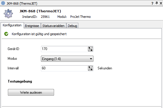

Configuration
The DeviceID defaults to 166 and must be added to the address of the respective device. Example: The ThermoJET has the address 17 - so 183 must be entered here. The ThermoJET has 8 inputs - if more than 4 temperature guides are connected, every second JKM instance with the mode setting: “Input (5-8)” must be added to IP-Symcon.
| Variable | Description |
| Output (1) | State of the 1st Relay |
| Output (2) | State of the 2nd Relay |
| Temperature (1..4) | Temperature value in °C |
Note: If no sensor is connected, the output is -99.9°C
If a second instance is created for input 5-8, the new variables are still called temperature 1-4. These can be renamed if required. The variables for outputs 1+2 are the same in both modes.
The four temperature channels (inputs) are queried cyclically in the set “interval”. The status of both outputs cannot be actively queried. This is sent automatically after the temperature thresholds set in the ThermoJET have been exceeded or undershot.
