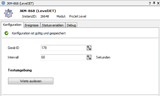

Configuration
The DeviceID defaults to 166 and must be added to the address of the respective device. Example: the LevelJET has the address 12 - so 178 must be entered here. The address is parameterized in LevelJET according to the manufacturer's instructions.
| Variable | Description |
| Distance | Distance in cm |
| Output (1) | State of the 1st Relay |
| Output (2) | State of the 2nd Relay |
The distance value (input) is queried cyclically in the set “interval”. The status of both outputs cannot be actively queried. It is sent automatically after the distance thresholds set in the LevelJET have been exceeded or undershot.
