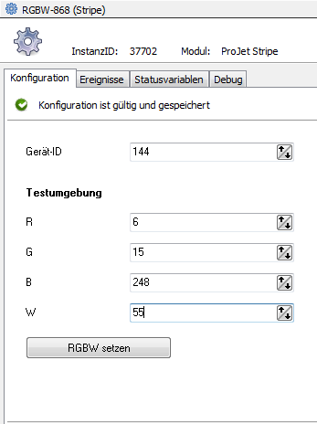

To communicate with the controller, you must first install the virtual comport driver and connect the USB radio transceiver. In IP Symcon 'RGBW(Stripe)' must be added. The parent instances (e.g. the gateway) are automatically created. Please check if the right COM-Port was selected.
Configuration
| Value | Description |
| Device-Address | By default, the ID: 144 is given. If more controllers are present in a system, a new ID will be awarded. Please check the jumper assignment in the instruction manual. Note: If necessary, the addresses: 149,150 and 151 are occupied by the system |
| Broadcast-Address | Fixed: 254 - all controller will be addressed together |
Only one device with the same ID may be present in a radio network.
A first test
For a quick check of basic functionality click the right mouse button on the 'RGBW(Stripe)' module, then 'Open Object' (or double-click) and choose a color, or, if connected, a brightness value for white-channel. Then click 'Insert'. The LED will light stripe in the desired color.
