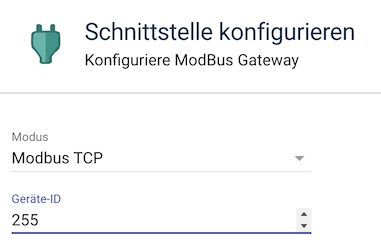

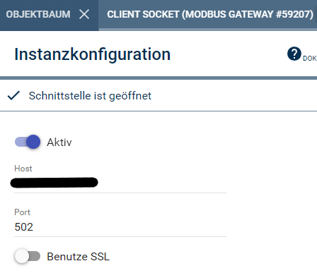

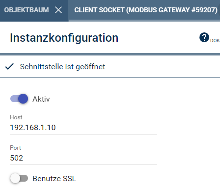

First, a "ModBus Device" instance must be added within the IP-Symcon object tree. The DeviceID must be set to 255 and the IP address of the wallbox must be entered in the following dialog. The port is 502 by default. Both pieces of information can be viewed on the web interface/app of the WallBox/charging pole.
KEBA Client Socket Configuration.: imageblock

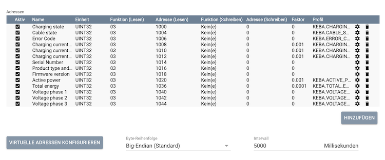

The ModBus template for KEBA wallboxes/charging stations can then be downloaded. This contains the entire configuration of the ModBus device. After downloading, the "KebaModBus_vx.json" can be loaded via "Import". All ModBus addresses of the common KEBA wallboxes/charging stations are then set up.
ModBus template for KEBA wallboxes/charging stations: Download
KEBA after loaded config: imageblock
Add addresses
If further addresses are to be added, this can be done via "Add".
Depending on the wallbox version, individual addresses may need to be deactivated/activated. This can be controlled via the Active column.
