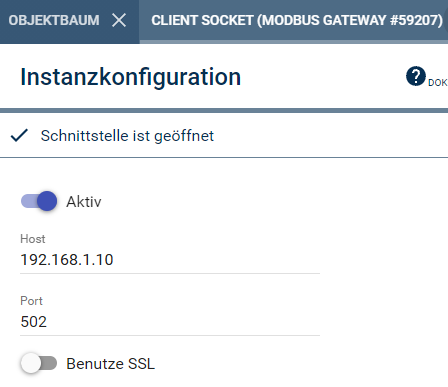

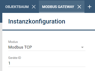

First, a "ModBus Device" instance must be added within the Symcon object tree. The IP address of the heat pump must be entered in the following dialog. The port is 502 by default. Both pieces of information can be viewed on the web interface of the heat pump.
Weishaupt Client Socket Configuration.
Weishaupt gateway configuration.

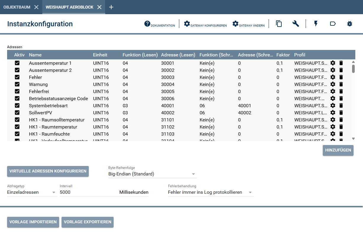

The ModBus template for Weishaupt heat pumps can then be downloaded. This contains the entire configuration of the ModBus device. After downloading, the "WeishauptModBusx_vx.json" can be loaded via "Import". All ModBus addresses of the standard Weishaupt heat pump are then set up.
Templates in the Device overview
Weishaupt device after loaded configuration
Adding addresses
If further addresses are to be added, this can be done via "Add".
Depending on the design of the wallbox, individual addresses may need to be deactivated/activated. This can be controlled via the Active column.
