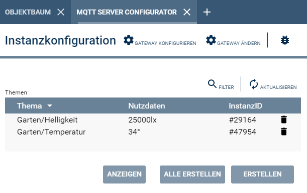

The server (broker) receives the values and properties of the MQTT devices. The configurator can read this data and displays all devices that have reported.
If a device is not to be displayed, it must be ensured that this device has sent a message to the server.
"Refresh" updates the display of all received topics and their last received user data.
The selected instance can be created via "Create".
Configurator

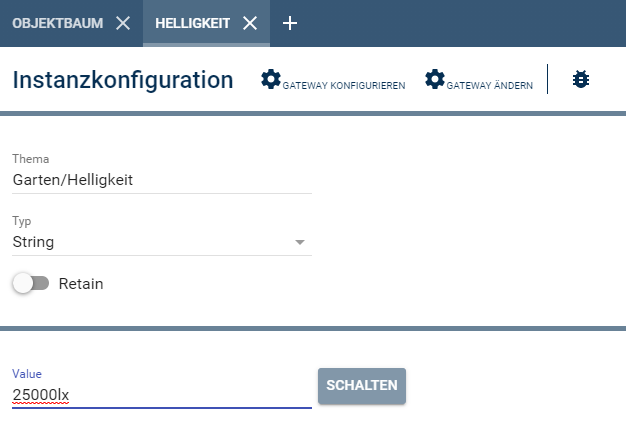

The configurator creates the path of the topic with the appropriate categories and the user data variable of the "String" data type. If a different data type is required, this can be changed in the instance.
Object tree
Instance
Devices that can only receive ("subscribe") and not send ("publish") cannot be created using the configurator, as it never receives anything from the devices. For these devices, an MQTT-Device must be created, a topic entered and a data type specified. (See also: Create instance)
