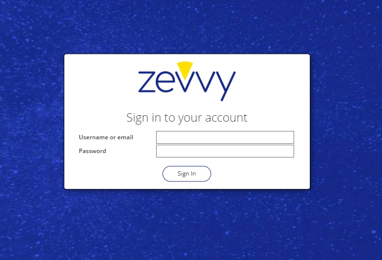

Before the variables can be set up, the Register button must be clicked. A new tab will now open in the browser with the Zevvy login screen.

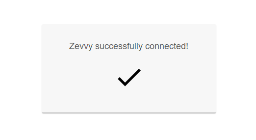

After entering the login data, the following dialog is displayed if successful.
You can now return to IP-Symcon. A token should now be present in the Zevvy instance.
