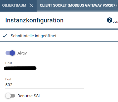

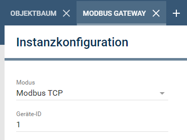

First a "ModBus Device" instance must be added within the object tree of IP-Symcon. In the following dialog the IP address of the wallbox has to be entered. The port is 502 by default. Both information can be viewed on the web interface of the wallbox/charging station.

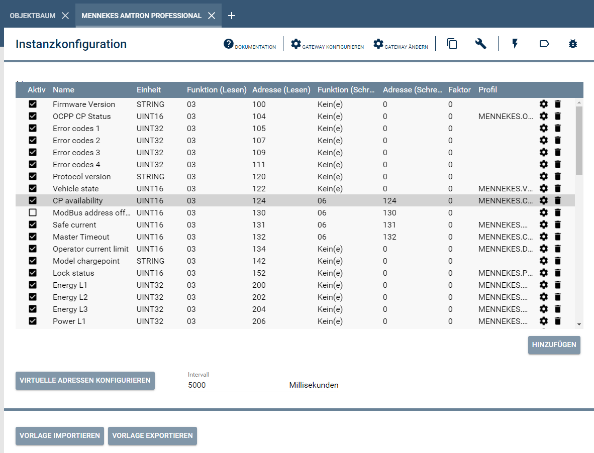

Afterwards the ModBus template for Mennekes wallboxes/charging stations can be downloaded. This contains the whole configuration of the ModBus device. After downloading, the "MennekesModBusx_vx.json" can be loaded via "Import". Afterwards all ModBus addresses of the common Mennekes wallboxes/charging stations are configured.
ModBus template for Mennekes wallboxes/charging columns:
Mennekes after loaded config: imageblock
add addresses
If more addresses are to be added, this can be done via "Add".
Depending on the design of the wallbox, it may be that individual addresses must be de-/activated. This can be controlled via the Active column.
