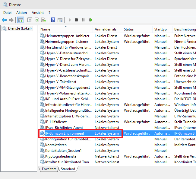

Call up the service management via Start > Run
%SystemRoot%\system32\services.msc /s
Service Overview

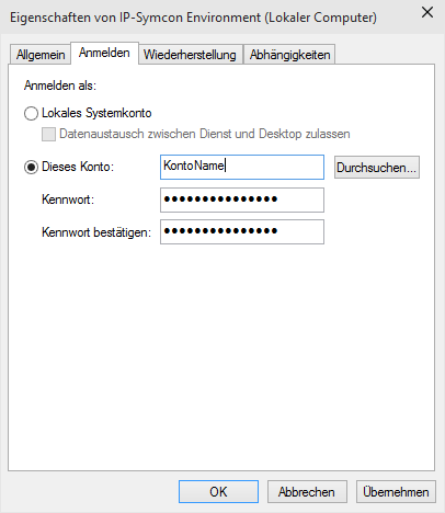

Double click on the entry IP-Symcon Environment. The following dialog should open and the password for the current user must be entered in the "Login" tab.
Register Service
After confirming with Apply/OK, the IP-Symcon service must be restarted. The easiest way to stop and start this is via the tray.
