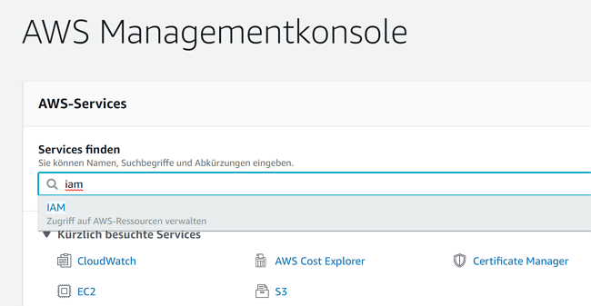

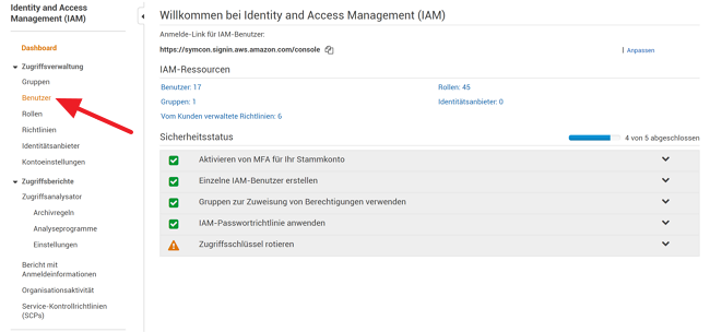

On the Amazon AWS home page, you need to search for the IAM in AWS Services.

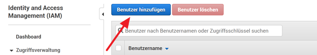

Within the IAM a new user has to be added

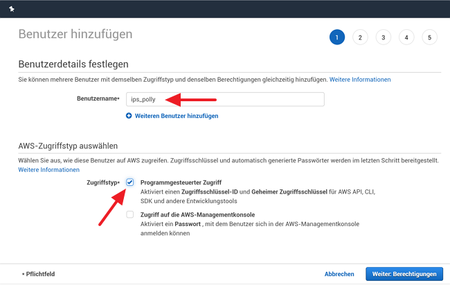

Afterwards, a speaking username should be assigned and "Program controlled access" should be activated.

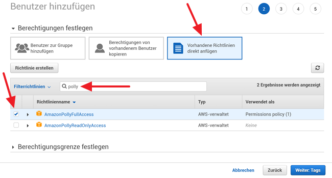

As a policy "AmazonPollyFullAccess" must be activated.
Skip the next dialog with "Next: Check".

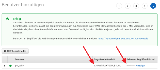

After creating the user, it will be assigned an access key ID and a secret access key.
