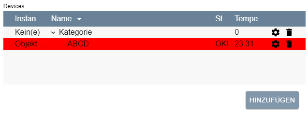

Beispiel
    "type": "Tree",
    "name": "Devices",
    "caption": "Devices",
    "rowCount": 5,
    "add": true,
    "delete": true,
    "sort": {
        "column": "Name",
        "direction": "ascending"
    "columns": [{
        "caption": "InstanceID",
        "name": "InstanceID",
        "width": "75px",
        "add": 0,
        "edit": {
            "type": "SelectInstance"
        "caption": "Name",
        "name": "Name",
        "width": "auto",
        "add": ""
        "caption": "State",
        "name": "State",
        "width": "40px",
        "add": "New!"
        "caption": "Temperature",
        "name": "Temperature",
        "width": "75px",
        "add": 20.0,
        "edit": {
            "type": "NumberSpinner",
            "digits": 2
    "values": [{
            "id": 1,
            "InstanceID": 0,
            "Name": "Kategorie",
            "State": "",
            "Temperature": 0
            "id": 2,
            "parent": 1,
            "InstanceID": 12435,
            "Name": "ABCD",
            "State": "OK!",
            "Temperature": 23.31,
            "rowColor": "#ff0000"
