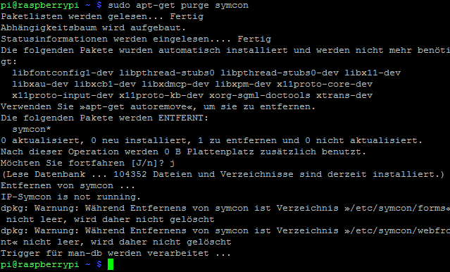

Uninstall Service/Server
The shown command needs to be entered via console. This is identical for Linux and Raspberry Pi.
sudo apt-get purge symcon
Uninstall
Delete IP-Symcon
Finalize the uninstallation by deleting the complete IP-Symcon-Data folder (/var/lib/symcon).
