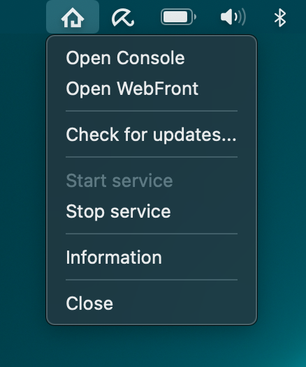

The latest version can be downloaded and installed by clicking on the tray icon and choosing "Check for Updates ‑> Install Update". Once the installation is complete, the service needs to be stopped and restarted via the tray icon.

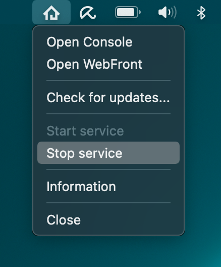

Stopping Service/Server
The service can be stopped by clicking "Stop Service" in the context menu of the tray application.
Stop service

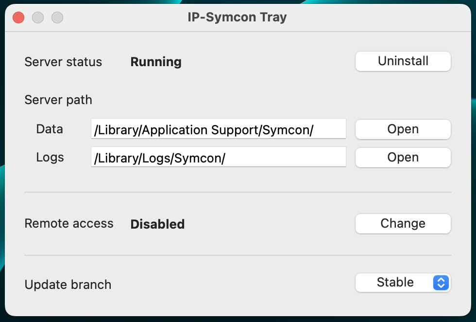

Via the "information" dialog the context menu can be opened. It should look like this:
MacOS
Uninstall
"Uninstall" removes the service from the system.
