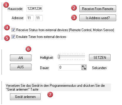

FS20 receiver / configurate sender
Configuration of FS20
  1. You can enter and take over the house code manually. Possible characters: 1-4
  2. You can receive the house code from another transmitter (e.g. a remote control).
  3. You can check if the address is already in use by another instance.
  4. When activated, the instance receives data from FS20 transmitters and updated accordingly, the state variable.
  5. When activated, the instance receives data from FS20 transmitters, evaluates the timer data and emulates the state of the timer (e.g. ON for 30sec).
  6. Once the new settings have been applied, you can test it by sending on / off telegrams. When transmitting the value in the duration field is rounded to the nearest possible time that can evaluate the FS20 system.
  7. Once the new settings have been applied, you can teach one FS20 receiver (eg switch socket). You must put this in the "learning mode" and program it within the next 15 seconds by pressing the teach button.

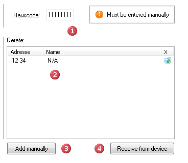

FS20 configurate remote control
configuration of FS20 remote control
  1. You must enter the house code by hand before you can continue the configuration. Possible characters: 1-4
  2. The list shows already learned buttons of the remote control.
  3. If you know the address, you can enter it manually. Possible characters: 1-4
  4. If you do not know the address, you can receive it from your remote control. Please note that you must have entered the house code and that it must be saved via the "Apply" button.
