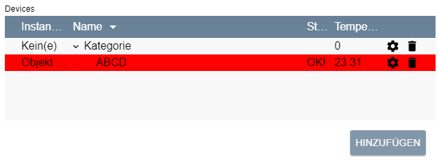

Beispiel
"type": "Tree",
"name": "Devices",
"caption": "Devices",
"rowCount": 5,
"add": true,
"delete": true,
"sort": {
"column": "Name",
"direction": "ascending"
"columns": [{
"caption": "InstanceID",
"name": "InstanceID",
"width": "75px",
"add": 0,
"edit": {
"type": "SelectInstance"
"caption": "Name",
"name": "Name",
"width": "auto",
"add": ""
"caption": "State",
"name": "State",
"width": "40px",
"add": "New!"
"caption": "Temperature",
"name": "Temperature",
"width": "75px",
"add": 20.0,
"edit": {
"type": "NumberSpinner",
"digits": 2
"values": [{
"id": 1,
"InstanceID": 0,
"Name": "Kategorie",
"State": "",
"Temperature": 0
"id": 2,
"parent": 1,
"InstanceID": 12435,
"Name": "ABCD",
"State": "OK!",
"Temperature": 23.31,
"rowColor": "#ff0000"
